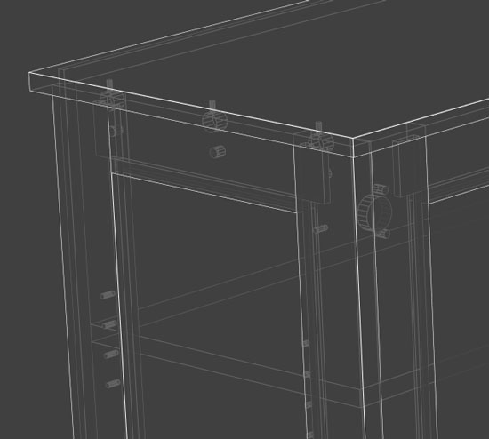

Hardware and assembly details automatically generated within Polyboard ready for machining
