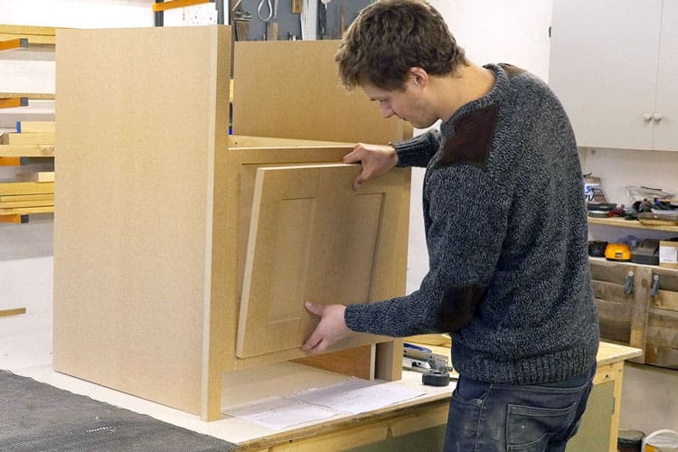

A cabinet maker who has completed a cabinet
Concluding a cabinet construction

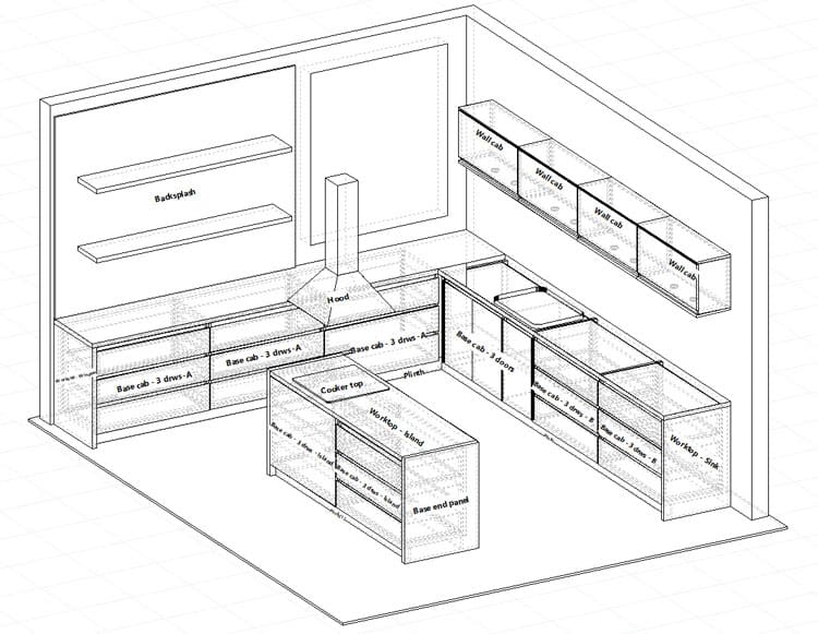

Types of kitchen cabinets you can make
Kitchen cabinets are a good example to start with, they are typically practical and easy to build.
Before constructing a project, it is important to understand the main types of cabinets commonly used in joinery. Selecting the right style will depend on your specific needs and the space you’re working with.
  • Base cabinets: sit on the floor and support worktops; these commonly come with doors, drawers, or a combination of both
  • Wall cabinets: wall cabinets are wall mounted above countertops and require strict installation standards
  • Tall cabinets: used for maximising vertical space to provide generous storage capacity
When you consider what type of cabinets you require, it’s essential to consider the materials and tools required to manufacture a strong, square, and durable unit.
Various cabinet constructions in a kitchen
A kitchen with many cabinet types

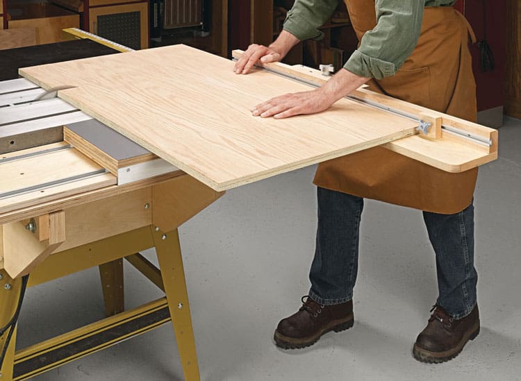

A worker operating a table saw
Cabinet maker using a sliding table saw

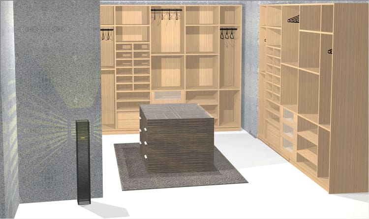

You can sketch out your project and manually calculate the parts you need. Unless it’s a very simple design, it’s better to use some kind of software. Drawing based CAD software is an option but it’s still a bit difficult to get the part by part dimensions.
Alternatively use a parametric solution like PolyBoard cabinet design software to size your overall cabinet carcass dimensions then drop in shelves and uprights, drawers, doors and plinths. The part by part plans and dimensions are then calculated for you.

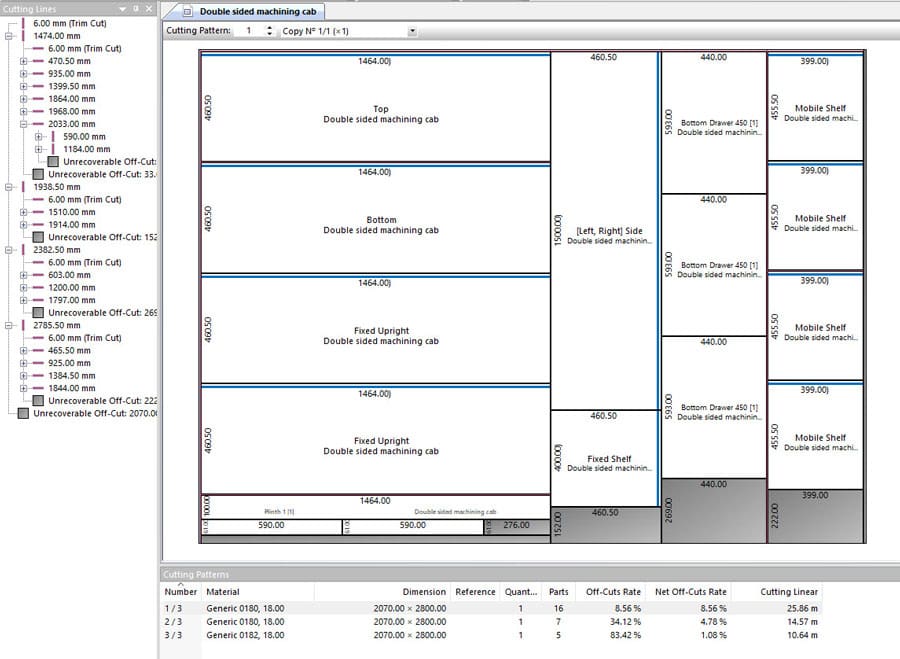

Once you’ve got a cutting list of parts, plan your cutting patterns for efficient cutting, then cut and label your panels.
Again, you can manually decide how to cut your parts for a panel material. Alternatively, go for one of many software options to support you with this process, see more information on our OptiCut panel cutting software.
An image from OptiCut
Optimized cutting pattern from OptiCut, plus cut sequence on the left
The benefit of planning cutting patterns and using software tools include:
  • Efficient use of materials
  • Faster planning and production
  • Reduced errors
  • Clear communication of cutting requirements

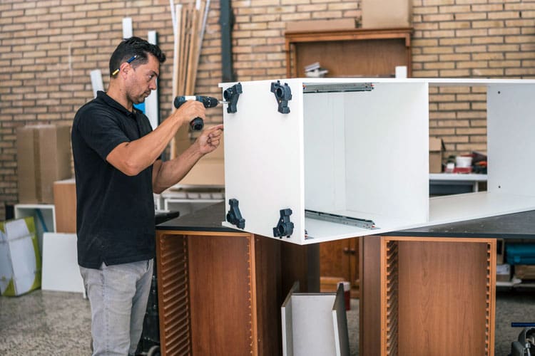

Cabinet making: assembly
Join all panels using your chosen fixing method. This could include screws, dowels, or CAM fittings. Check the cabinet is square and fastened securely.
When assembling cabinetry, you should always:
  • Confirm a cabinet is square in each corner
  • Pre-drill where necessary to prevent splitting
  • Use the chosen fixing method consistently across a project
  • Tighten all fasteners fully, but don’t over drive them
  • Inspect each assembled cabinet for problems
Assembling cabinetry with a drill
A cabinet maker assembling a cabinet with a drill

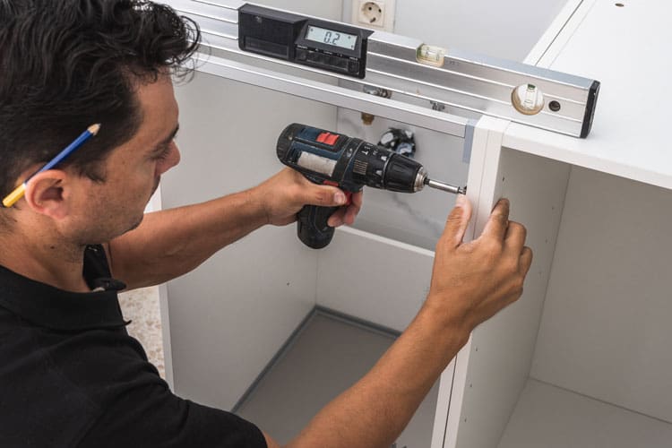

A worker using a cordless drill to assemble cabinetry hardware
Installing cabinetry feet and drawer runners

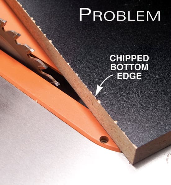

A poorly cut piece of material
Avoid chipped melamine from a blunt blade
