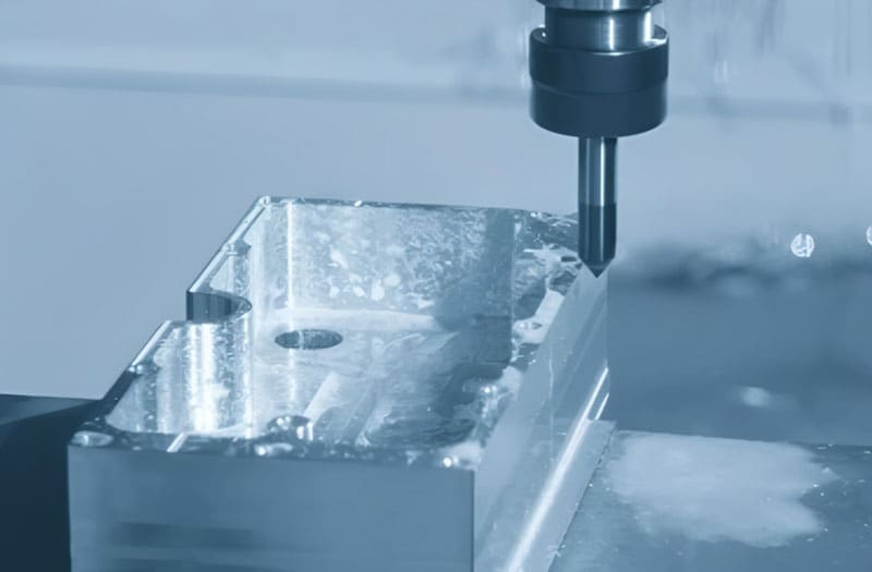

Creating a clean and accurate chamfer on a 3-axis CNC machine can be a challenging or even impossible task without the right software tools. This process is simplified in VCarve Pro and Aspire by offering a dedicated chamfer toolpath that provides flexibility and provision through its easy-use range of applications.
A 3-axis CNC machine cutting a chamfer
3-axis CNC chamfer cutting

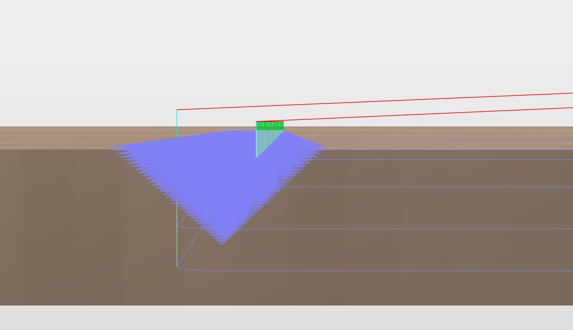

When using a V-cutter, VCarve Pro enables easy toolpath generation through user set widths and depth parameters. This is especially useful when working with common angles, such as 45°, while still allowing control over the final appearance of the edge.
An image of a V-Cutting tool bit
120° V-cutter

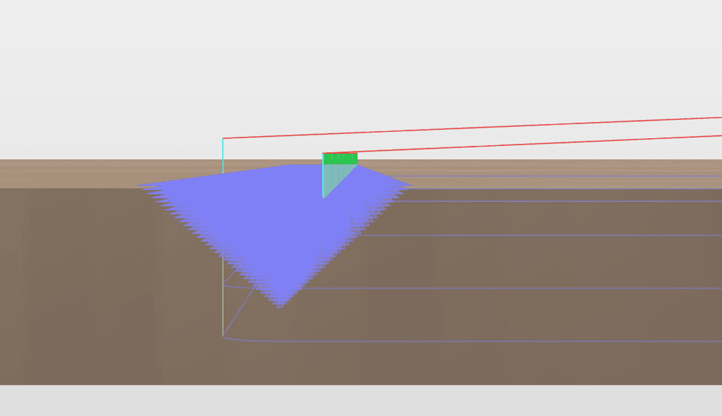

The ability to chamfer both on the inside and outside of a vector in VCarve Pro enhances the flexibility and customization for a designer or machine operator.
A chamfered component in a V-Carve Pro simulation
Chamfer in VCarve Pro with a V-Cutting tool

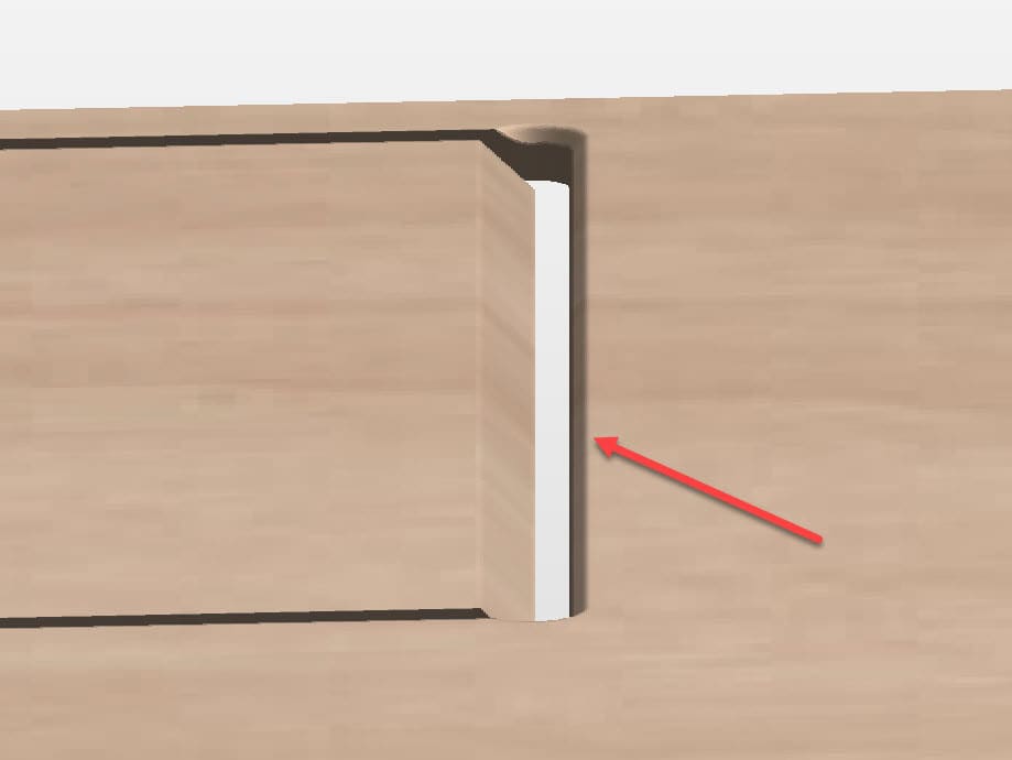

Here is an image of the resulting toolpath in VCarve.
An image of a chamfer toolpath’s intended cutting path
Chamfer toolpath
