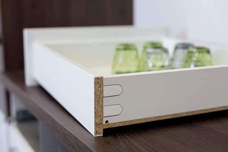

Butt joint
A butt joint is a basic joinery technique that involves joining two pieces of wood by butting them together. Butt joints are best for:
  • Quick construction
  • Internal cabinetry structures
  • Projects where CAM fittings, dowels, or screws are used for strength reinforcement
This technique is easy to assemble and fast to create, although it can be weak on its own without additional support.
A drawer back and side connected with a butt joint and CAMs

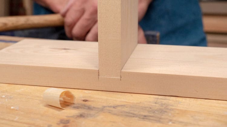

Housing joint
A housing joint sees a groove cut into a piece of timber to house another. Housing joints are strong and stable, making them great for:
  • Shelves
  • Cabinet carcasses
These joints provide great part alignment, although they require a high level of accuracy in production. This is an efficient joinery technique with the correct tools and equipment.
Housing joint manually cut into timber
Housing joint

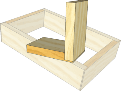

Rebate joint
Rebate joints are produced through cutting a recess along the edge of a piece of timber. These joints are fast to make and a great for:
  • Cabinet backs
  • Drawer construction
Rebating timber allows for a simple yet strong joint, and helps with alignment in construction. Note, even though rebating is stronger than a butt joint, it doesn’t offer strength in all directions of force.
Rebate joints strengthening a box
Rebate joint

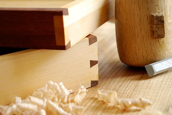

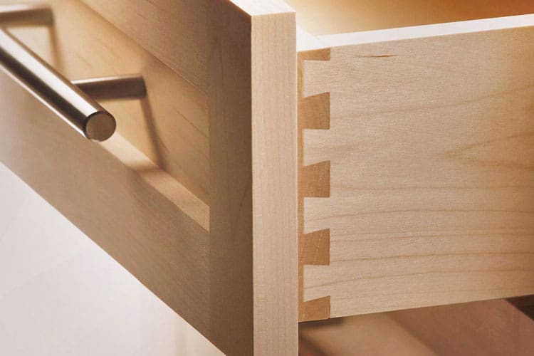

Dovetail joint
A dovetail joint is a traditional woodworking technique that sees interlocking pins and tails connect perpendicular pieces of timber. These joints are known for strength and quality craftsmanship, being widely used in high end furniture and cabinetry construction.
Dovetail joints are ideal for:
  • Solid timber furniture
  • Corner connections needing high strength
These joints strongly resist pulling forces, making them perfect for boxes and drawers that experience common ongoing use. They create a premium appearance that is valued across the woodworking industry. Note, these joints are complex and time consuming to manufacture and usually require specialist jigs and equipment.
A drawer box made with dovetail joints

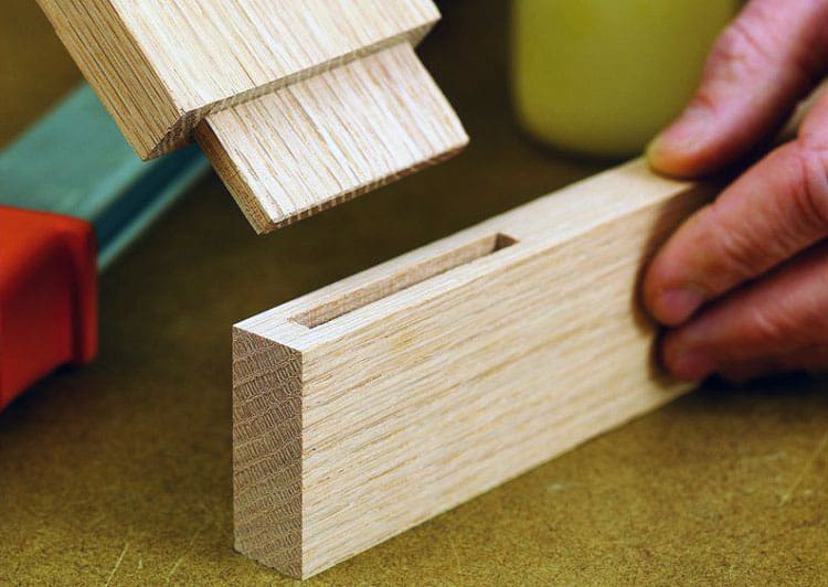

Mortise and tenon joint
A mortise and tenon joint is one of the strongest, most common woodworking joints used in cabinet and furniture making. The joint involves a tenon (the arm) fitting into a mortise (the slot). These joints are really ideal for:
  • Structural cabinet frames
  • High stress applications
The benefits of these joints are their extreme strength and versatility. They can be more time consuming than other joints, and require precision skills or equipment for manufacturing.
A mortise and tenon joint being assembled

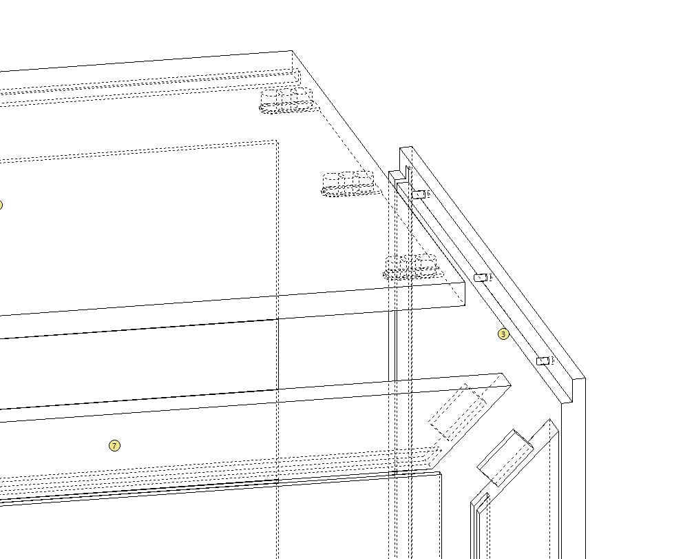

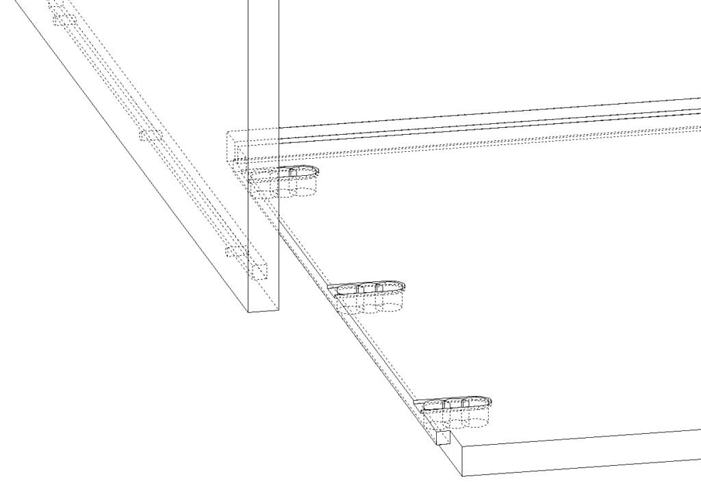

Explore PolyBoard’s advanced joint management
PolyBoard is a modern cabinetry design software that bridges the gap between the traditional woodworking joints and efficient manufacturing.
Within PolyBoard you can:
  • Apply different joints across cabinetry
  • Accurately manage tolerances and sizes
  • Combine traditional and modern joints and fittings
  • View fitting and production documentation before manufacturing
PolyBoard is a tool that will take the guesswork away from joinery and allow a manufacturer to streamline cabinet production. If you would like to explore how PolyBoard can help you design, visualise, and manage your manufacturing, contact us here.
