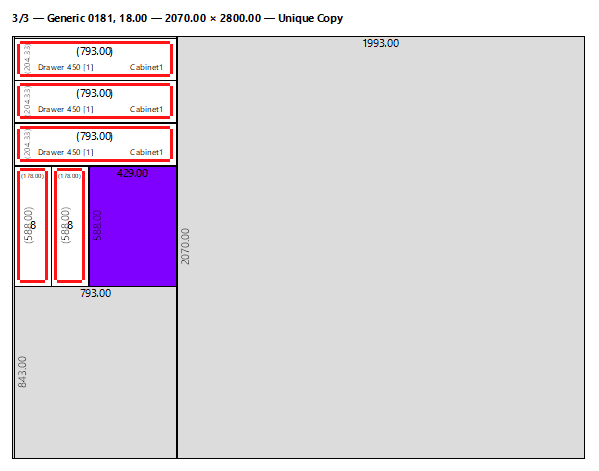

This image shows an OptiCut cutting pattern for a panel material. Usable off-cuts are shown in grey and unusable in purple.
cutting pattern output in OptiCut
Cutting pattern in OptiCut with off-cuts shown in grey and purple

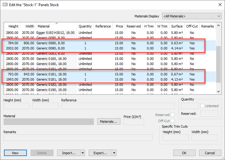

And here is the panel stock showing the off-cuts re-introduced for use in a future optimization.
Keeping a management system for stock in OptiCut
Panel stock management in OptiCut with off-cuts highlighted
