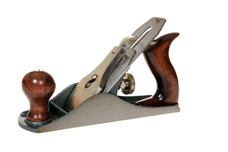

Whilst types of plane vary, most have parts in common, these include:
  • Iron: the blade or cutting edge that does all the work
  • Mouth: this is the gap or aperture that the iron protrudes from
  • Tote: the hand rest at the rear of the plane for driving
  • Knob: the hand rest at the front of the plane for guiding
  • Lever cap: a plate that lies over the iron that levers into place and holds everything firm
  • Sole: the base of the plane
  • Depth adjustment: a finger dial that increases or decreases the amount of the iron that protrudes from the sole
  • Frog: adjusts the angle of the iron

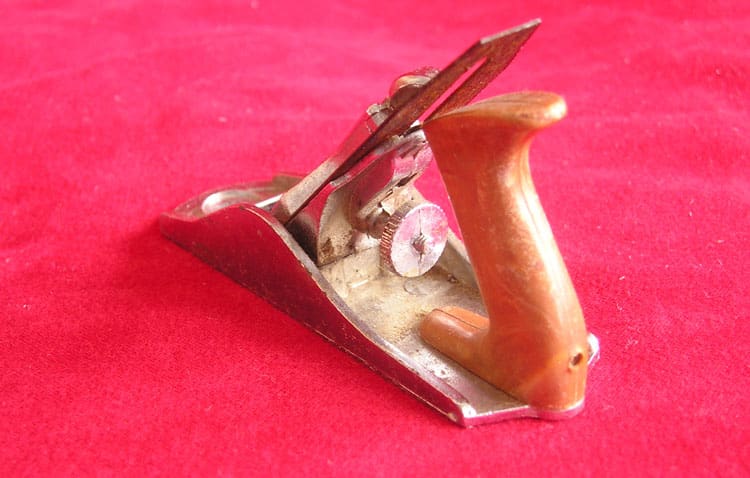

  • Sizes 1 & 2: in today’s powertool dominated world, these very small planes are very rare and are usually only used for very specialised tasks or as collectors items

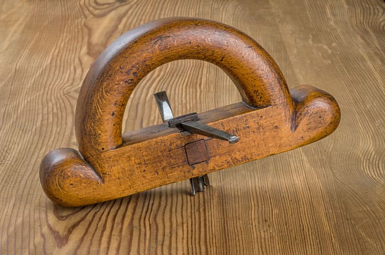

Router Plane
This type will cut a groove or recess of a uniform depth and width. They often have interchangeable central irons with different widths that protrude through the sole and can be adjusted to different depths.
Antique router plane
