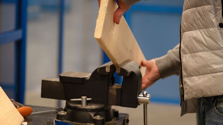

Front vise
This is the type most people will be familiar with, also called the face vise, one will be attached to the front of the workbench to the left or right to suit the handedness of the user. Typically metal jawed with a tightening screw on the front, they are best for chiseling, planing and sawing. Choose a model with a quick-release mechanism which allows you to slide the jaw open or closed instantly without cranking the handle.
Front or face vise

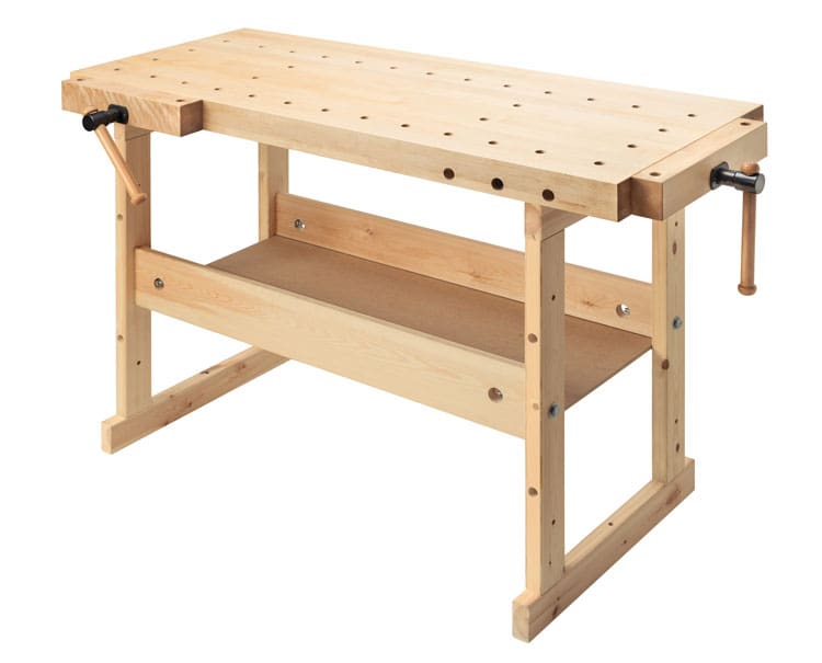

End vise
This type is also known as the tail vise and will be located at the end of the bench. It operates in tandem with movable pegs or “bench dogs” that plug into holes in the bench to hold a flat sheet or board in place for working on. This type of vise is best for surface planing and sanding large panels. Since the pressure is applied lengthwise, the workpiece remains perfectly flat and unobstructed.
Wooden bench with vises
