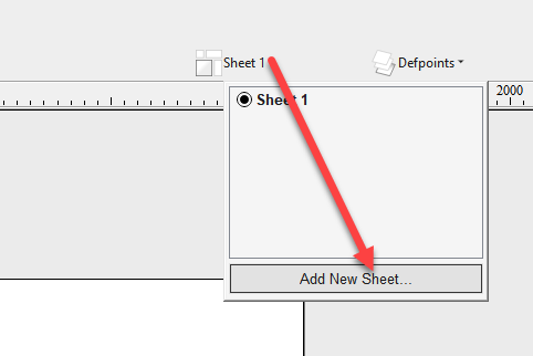

If you divide a part from an axis, milled on the outside, with the same tool, there’s no reason why you shouldn’t get the complete final shape when assembling.
additionnel sheet are create when using nesting feature or manually
sheet.pngImage Enlarger
All the best, Alex

June 12, 2025 - 1:11 pm
hi Alex
we don’t have the up to date vcarve so we only have one sheet, but i did understand the node edit mode to cut the shape in half which i have done but can you just answer my question about the toolpath that it will cut outside the shape and when joined it will be correct size.
