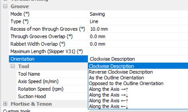

The options that you selected are for the orientation of the saw blade itself, rather then the component.
To set a fixed component orientation, you can test the following outputs:

Please note, there may be moments when you decide it is best to manually rotate some pieces in BNest.

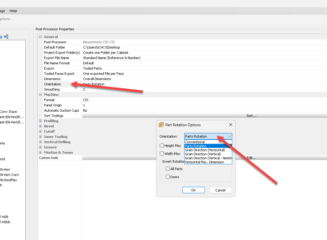

Hey,
Is there any way to set up PP so that all pieces that have groove sawing are oriented same way (along X axis)?
PP.jpgImage Enlarger
tried all of these options and “Orientation” option under General tab. Nothing useful really happening the output is still the same. Only flipping pieces so the ones that had cuts horizontally are now vertical and vice versa.
