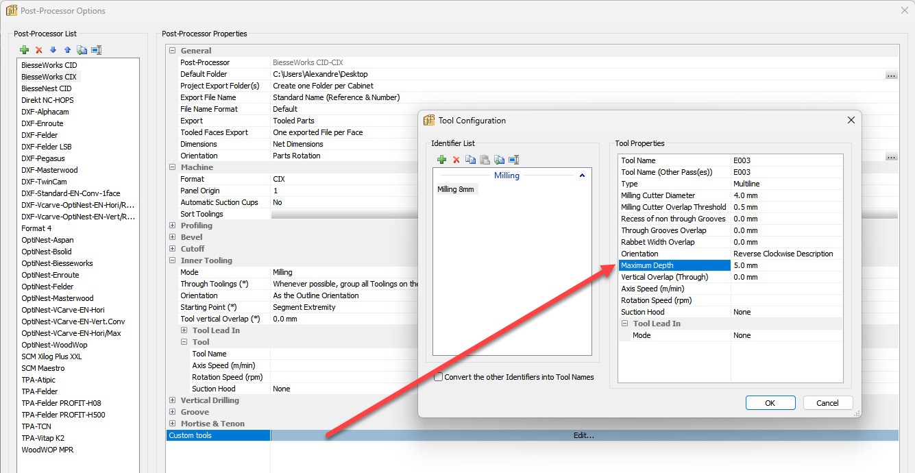

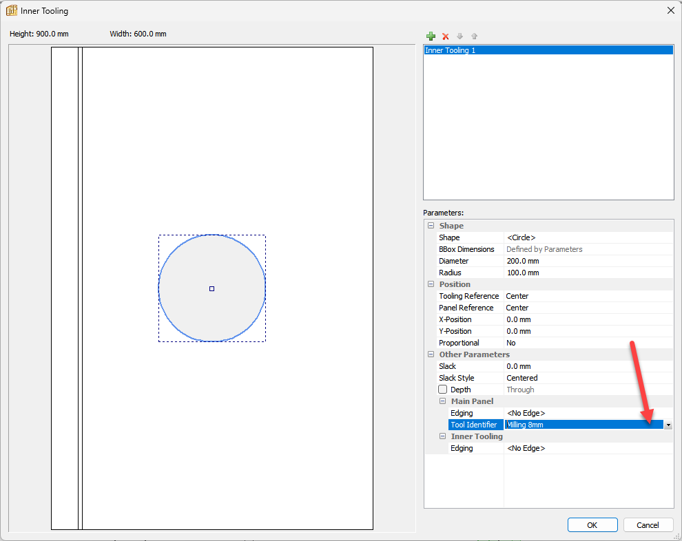

To do this you need to use Tool ID, from PP option, then define Maximum Depth per pass option.
Then set this Tool when you create you inner tooling.
Hope that’s helpful, Alex
ct.pngImage Enlarger
tid.pngImage Enlarger

Can you please advise on how to change the settings in the Post Processor for an inner tooling? See the attached file.
I would like to make a 15mm inner tooling in a 23 mm thick board, with 3 passes with 5 mm in thickness per each pass.
I now that it is possible to make this kind of setting for milling under residual thickness, is it possible to make the same setting for an inner tooling? Or do I put in the max depth in the settings for the tool?
