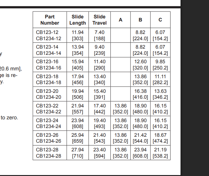

I’m pretty sure I’ll need this item, as the door is over 1m tall. Accuride 1319/1316 parallelo set
The door is ~490 mm wide so the depth of the slide will have to be 500 mm, door thickness 16mm, height 1930 mm.

Regarding the Hafele hardware system, this can be added to the cabinets. I can show you how to do this, although I will need some more information first. See the following link to the Hafele Technical sheet.
Please let me know which system here you need:
Technical-sheet.pngImage Enlarger
