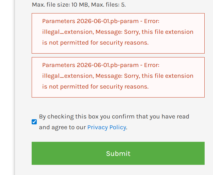

SORRY TO BOTHER YOU BUT IT IS GIVING ME THIS MESSAGE
TO-ISACC.pngImage Enlarger

June 1, 2026 - 11:48 am
Hello Emanuel,
See the upload link attached. Please remember, we do not need to texture files to be apart of the parameters.
File uploader

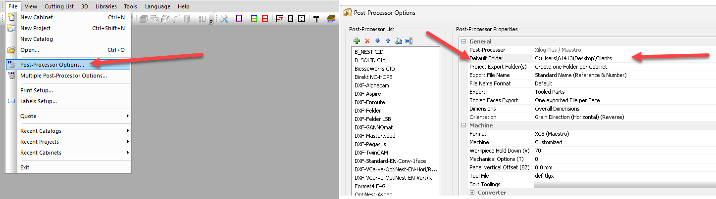

May 22, 2026 - 1:41 pm
Hello Tony:
a) Any new issues will be from changes to the PostProcessor settings as nothing has changed from our side. Can you please let me know what changes have been made recently and I will investigate what could cause these problems.
Additionally, please send me a copy of the PolyBoard parameters.
b) If you are having problems with the 3D preview, please confirm that you have updated to our latest version, PolyBoard 8.10j. This can be updated on our website in your account’s downloads.
c) To set a default directory for saving files, this can be set under the Default Folder in the PostProcessor settings.
See this in the following image:
2026-05-22_13-39-44.PNGImage Enlarger
