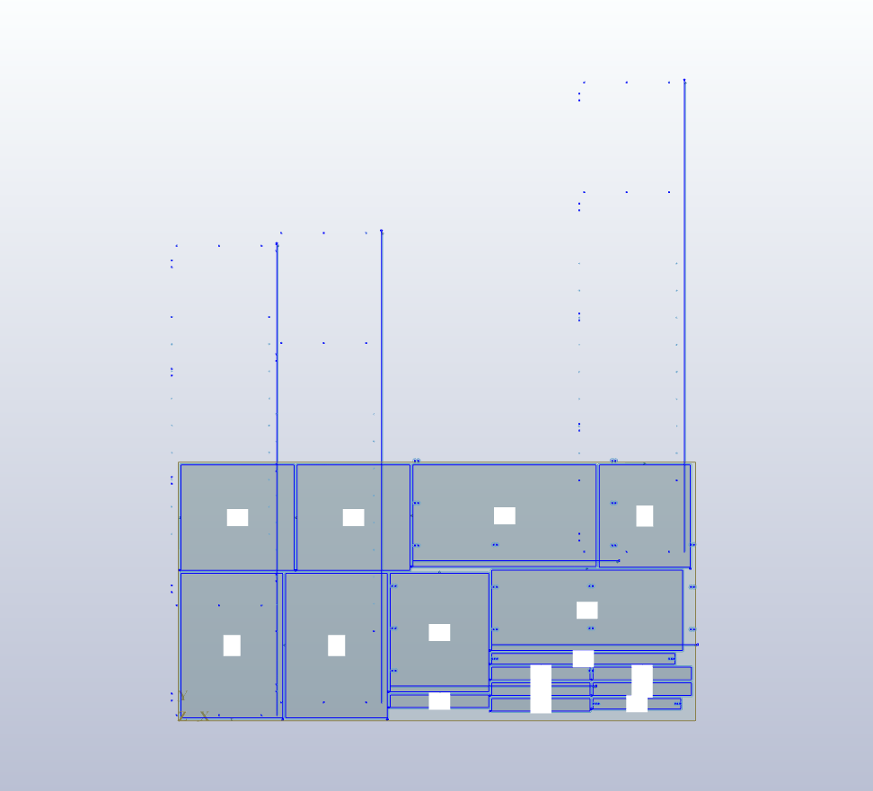

Hi Emmanuel,
From what I understand, this is a manually created error and not an issue coming from PolyBoard. I do not have detailed information about how Maestro’s optimization works, but it is likely that during optimization, it combines certain tool paths to reduce milling time. This means that if you delete only one part, it may create an error in the tool path.
I think it makes more sense to modify the parts before optimization, or directly before exporting from PolyBoard depending on the modification needed.

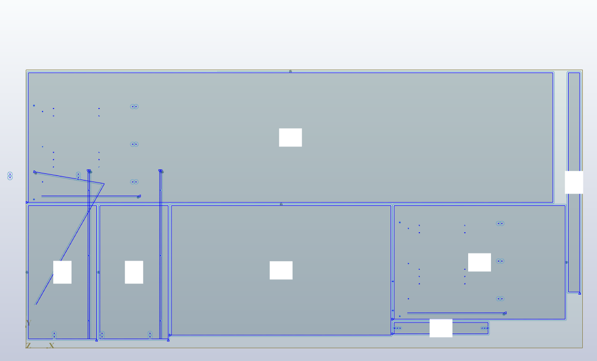

I had a problem on maestro that its getting me really bad as i cant work and would like to know if i am doing something wrong on polyboard .SO the problem is that when i do the transfer from poly to maestro the nesting comes well.When i need to edit something on the nesthing program all works vanish or get confused like fittings get over each other etc.
Can you help pls.
Thank you
