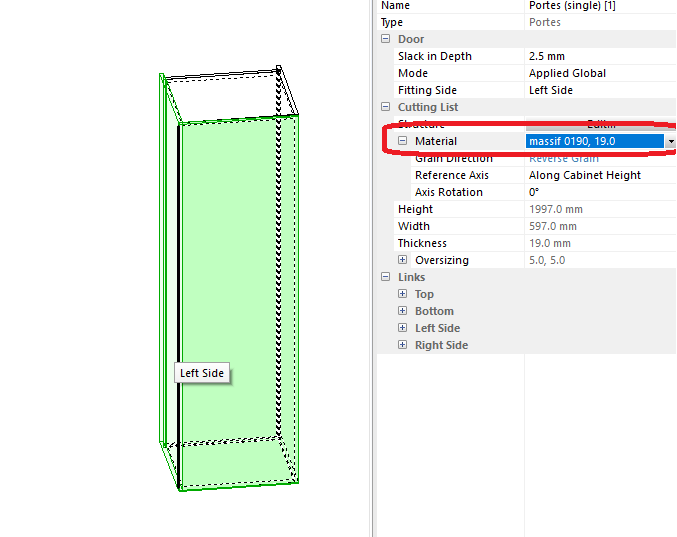

first to make your cabinet you need to use material with grain
on Libreraies>sub-methods>Material style
or select panel and choose material with grain
this give us cabinet with grain

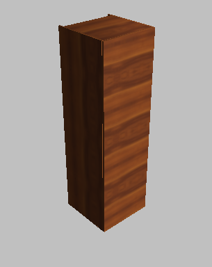

after you select panel and set grain direction to reverse for this exemple
and after cabinet will look like this
OptiCut will auto reverse panel into cut list
