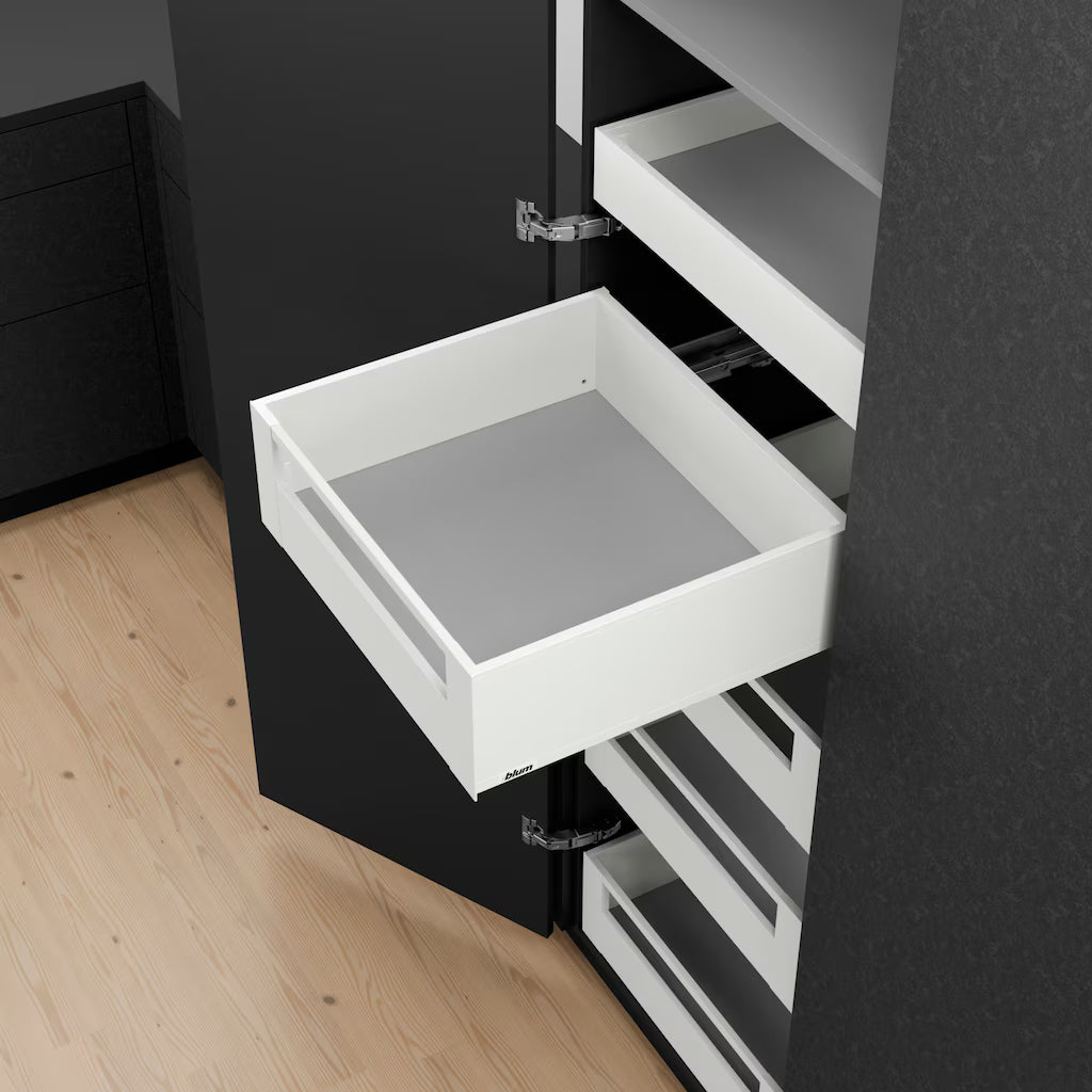

So often in a kitchen u want to use 2 Legrabox C drawers with a front, and a cutlery Legrabox M inside – that comes with an aluminium front which does not need extra recess for the holes of the gliders, they can stay on 37mm although 40mm is what i prefer , so a recess of just 3mm ( instead of the thickness of the front which is what Polyboard automatically does ).
My questions , please:
1. How do i configure 2x Legrabox C with a front and 1x Legrabox M recessed 3mm for the holes, not more, that comes inside. Not equally divided in 3, normally u divide the space in 2x for the C and u put the M above, as shown in the picture.
Blum Legrabox binnenlade - Hoogte M (109mm) - 550mm - 40kg - OriongrijsImage Enlarger
2. How do you add only Legrabox with the metal profile as shown in the picture below, inside drawers which again ask 0 recess for the gliders holes even when built-in, it stays at 37mm from the front. And op top of those we can add a normal door ( usually with hinges of 155 opening ). This is called a SPACE TOWER from blum, and its to be configured by everyone’s needs.
Blum Legrabox pure kitset one door Length 500-550mm ,5 × 40kg Space toImage Enlarger
If these things are too complicated, its okay for me to also add just the holes at the heights i need, since i am buying the drawers anyway and i dont need to manufacture anything about them, if the visual can come for the client its perfect, but otherwise i’d be fine with just being able to add the fittings holes at the chosen dimensions, sometimes equally divided to the space provided, sometimes custom spacing. Which leads to question 3.
3. How do i apply just fittings, with no drawers to manufacture, or, how do i add the drawers since but remove them from manufacturing directly from the configurations, so i dont have to manually do each part of it.
