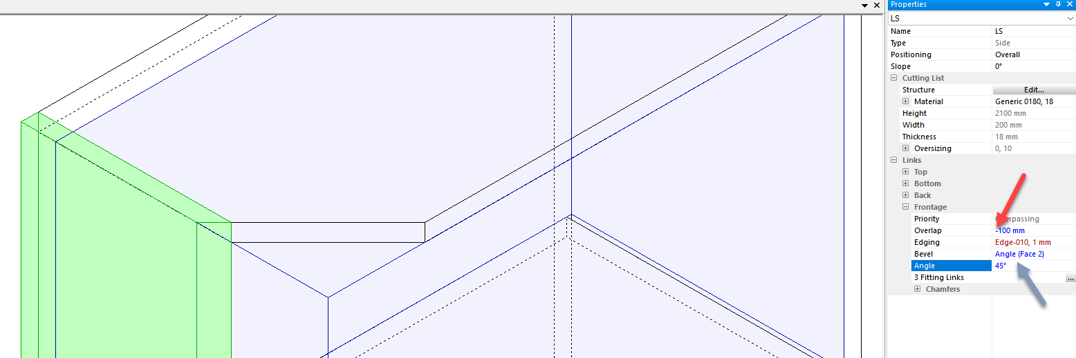

You can add a negative overlap to set the piece in recess from frontage.
Recess.pngImage Enlarger
Hope this helpful, Alex

May 22, 2025 - 12:18 pm
dear alex
i am noticed that i changed the design by it is not updated ,i cant understand why.
Now i rename it so i hope this is what iam doing .
Emmanuel Sacco
Forum Posts: 198
July 5, 2024
May 22, 2025 - 12:16 pm
daer alex
hope this is what you need
Forum Posts: 2128
May 22, 2025 - 12:13 pm
To be sure I’ll go in the good way can you share draft of your need ?
Thanks, Alex
Emmanuel Sacco
Forum Posts: 198
July 5, 2024
May 22, 2025 - 11:49 am
Dear ,
Iam trying to desing this corner and need that the side will be 5mm inner than the finished corner .How can i make the side narrower.
thank you
