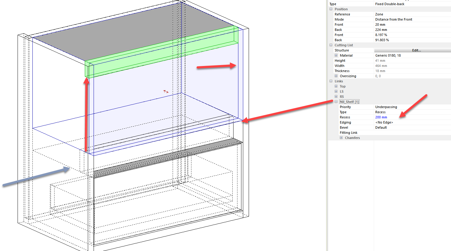

1* Which slide do you want to use, because 262mm is really short and I don’t know of any drawer so small
2* With the recess creating an invisible panel, which means you can’t add drawers,
The best solution is to add another nil shelf (green arrow) to delimit the zone and add drawers underneath.
drw-edit.pngImage Enlarger
hope that’s helpful, Alex

Dear
thank you for your replay of the corner unit .I am doing this small drawer unit for saloon that need to be very narow and client want 2 drw inside .I tried but software its not letting me do them .
thanks
