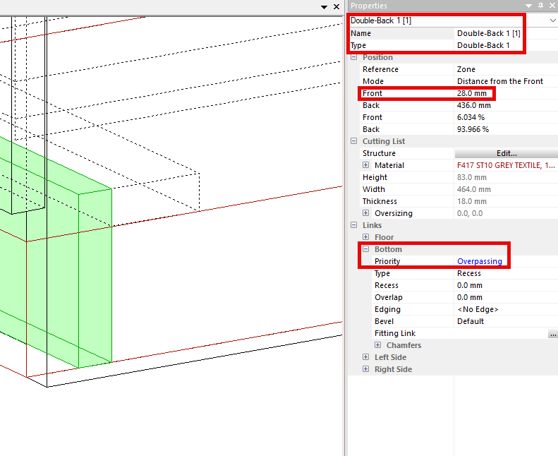

Hello Brad,
I apologize for the late reply. In order to be able to link the bottom panel with the plinth please do the following: delete the current plinth panel -> set the Elevation for the Plinth (External Zones) to 0 (zero) -> select each side of the cabinet and set to Overpass the bottom panel with the desired plinth height (65 mm) -> add a Double-Back panel (not a plinth panel) and set a recess value from the front so the panel in in line with the bottom panel -> select the Double-Back panel and set it to Overpass the bottom panel -> add the fittings.
fix_1-1.pngImage Enlarger
Regards, Petru

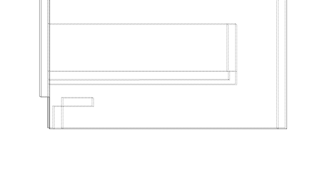

September 23, 2026 - 12:34 pm
Yo,
I’m trying raise the plinth 18mm so I can link it with the surface split panel.
Image and file attached.
Thanks,
JonnyPLINTH-RAISE-.pngImage Enlarger
