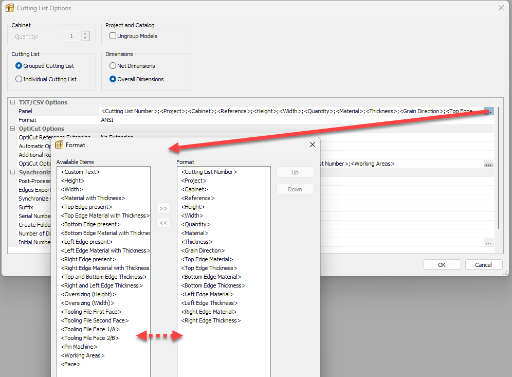

If your goal is to export a CSV file, this can be done directly from PolyBoard.
Go to the Cutting List menu, then Cutting List Options. All of the fields can be easily reorganized to suit the CSV format required by your saw.
All the best, Alex.
