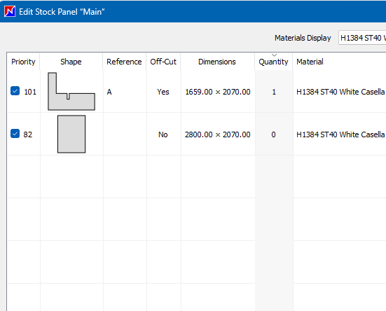

  I think we are talking about different priorities. Let me show you;
Screenshot-2025-06-20-124320.pngImage Enlarger
The priorit on here shows the priorty of ALL your panels, not the selected material type. I would like to prioritise, if possible, each material type.

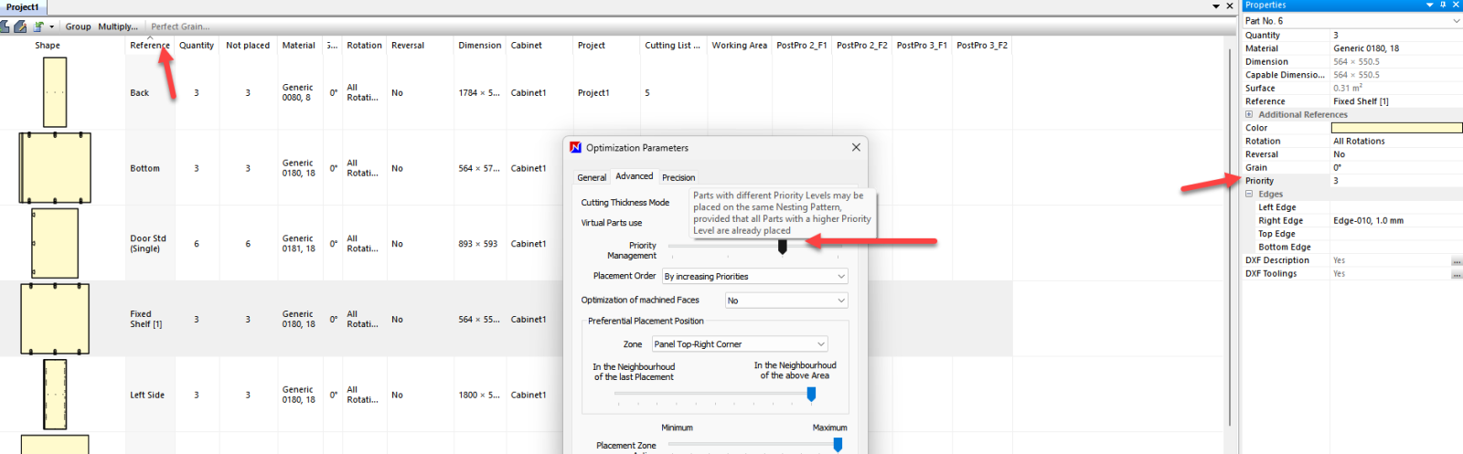

Can you give my more details of your goal?
Because I see in our records you already have ON 3, and in ON 3 , each material are assign to a single panel for Nesting,
If goal is to cut for exemple shelves at the end of nesting, that’s can only be done from ON by sorting parts per name and increase properties numbers ,
then change priority managements cursor
Priority.pngImage Enlarger
Hope that’s helpful, Alex
