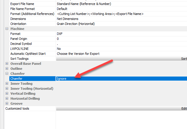

Hi Alex,
  Thanks for the reply. i had a call with Isaac this morning regarding some other bits and we got this sorted. turns out it wasn’t in “ignore”, but the toolings were not set on import options. these have now been set as;
/*.CHANT*;/EDGE.*;/PANEL*;
Dean
January 28, 2025 - 7:46 am
in nesting, this isn’t possible most of the time, and if you check your PP option, we’re probably in ‘ignore’ mode, which at least allows the parts to be cut to finished size to finish cutting the angle in the saw
PP-chamfer.pngImage Enlarger
But if you want to try it, you can switch to ‘tip done’ to add a line, and place the tip of the cut down IF POSSIBLE, because machining remains the priority,

Hi folks,
  I have some angled back units which I would like to nest as cut panels. I have googled the hell out of this and can’t find any info.
Please see a cabinet example attached. The side as an angle cut from it, but when I post-process it through to Optinest, it does not recreate the angle. Can you help?
Dean
