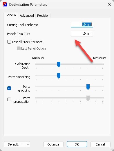

March 7, 2025 - 11:42 am
Dean,
Panel trim cuts, as seen in the attached image, are set for the optimisation of all panels.
Panel-trim-cuts.jpgImage Enlarger
If you want this removed for your off-cut material, you would need to nest these separately and set the panel trim value to 0mm.
This cannot be changed between different panels in a singular optimisation.

March 6, 2025 - 9:32 pm
Hi folks,
  I cut my parts out of a large sheet, and optinext can return the offuts to stock, however the dimensions it returns are wrong to the panel.
I have found this is because it is assuming that the edges are trimmed. I have set trim to 10mm to make sure the parts do not optimise on an edge.
I would lik my offcuts to be the size that is being returned. Can you help?
