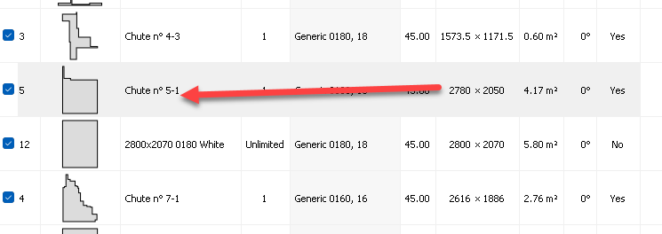

Hi Caroline,
To save off cuts in OptiNest, use the icon in the following image:
2026-02-20_15-35-32.PNGImage Enlarger
When this has been completed, you should see your off cut material saved in your stocks:
2026-02-20_15-36-08.PNGImage Enlarger
To adjust the minimum sizing of your off cuts, this can be completed under Tools>Options:
2026-02-20_15-38-26.PNGImage Enlarger
Any manual changes to this in VCarve cannot be automatically updated back in OptiNest.
I hope this helps, let me know if you have any further questions.

Hi
I have a couple of questions re using off cuts from optinest
see attached file from optinest how do i save the remaining board that is not used so that it can be reused in another job?
When i cut this job in vcarve (see attached file from vcarve) i moved the panels so that we maximised the board, can we save the remaining board to use again in another job?
