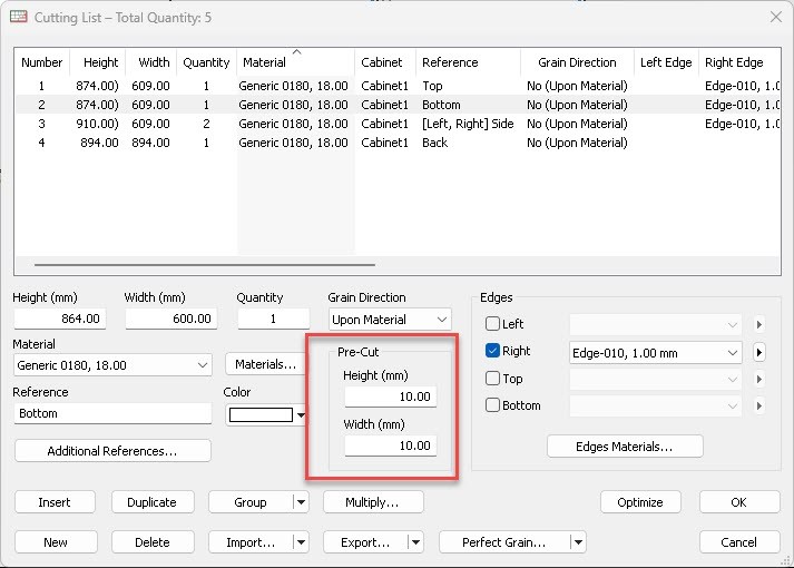

Hello Tom,
If I have understood you correctly, you often oversize all of your components and cut them on one day, and then trim them all to a finished size the next day?
I have been working off of this understanding and trying to find an efficient solution for you.
I believe that selecting all of your components and adding a “Pre-cut” value is the best practice.
Pre-cut.jpgImage Enlarger

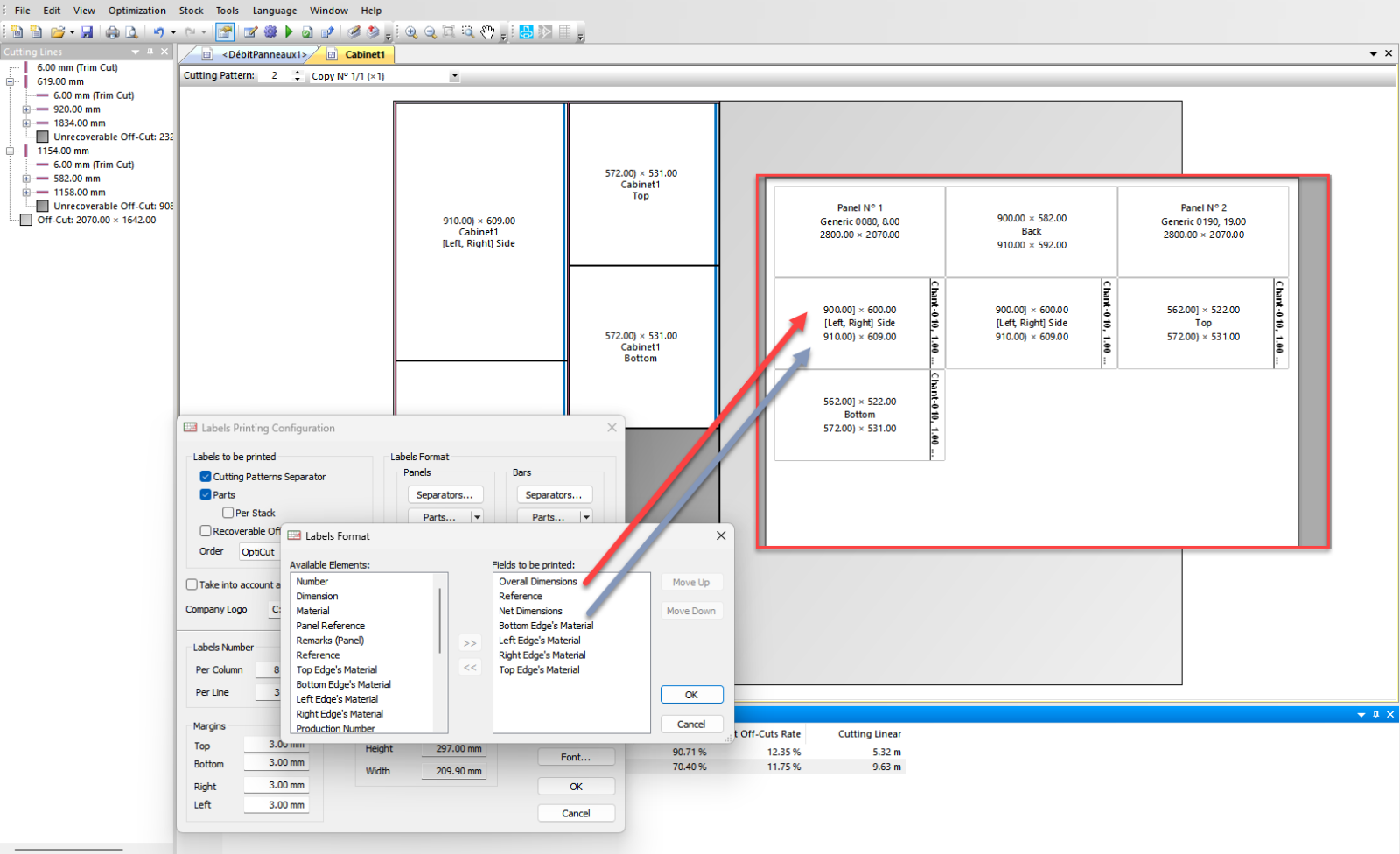

Additionally, you could add an oversizing to all of your components using a “Grooves and oversizing” rule in PolyBoard, and then set net dimensions to your part labels for a finished size (if you are using labels).
