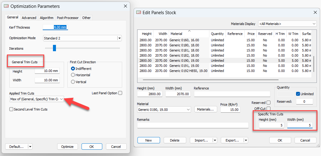

Hi Dean,
There is currently no other solution.
If you use a “Min” option, knowing that the default specific trim cut value is nil, you must start by setting
this value equal to the standard value for all panels (using CTRL A) before individual adjustments.
The way you do it now is the only current solution
regards
Michel

* For Trim Cuts you have 2 levels, from Optimization parameters (generals) AND from panels Stocks (Specific)
Then from Optimization parameters you have choice to select General and/or Specific
After your are free to use the most useful for you, for exemples 0mm to generals then 10 mm for some panels

Hi folks,
  I have set my standard trim edges to 10mm as I am using jumbo boards which usually come very rough. I have a couple of panels which are edged that I would like to put into stock that already have edges… I tried using specific trim edges but that seems to ADD to the 10mm (i.e. 10+8 specific).  So 2 questions;
1) Can I OVERRIDE this, not add to?
2) Can I tell opticut not to worry about trim edges on some panels?
Dean @ Rooms Made Simple
