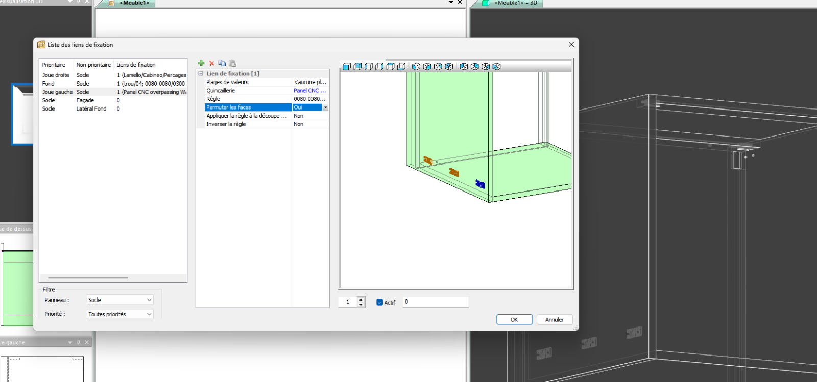

I understand the confusion here, but the opposite is actually true.
It’s a bug (a problem) in PolyBoard 7 that was fixed in PolyBoard 8.
So it wouldn’t make sense to put a bug back in.
I made a video to show you the problem that was fixed.
Hope this helpful, Alex

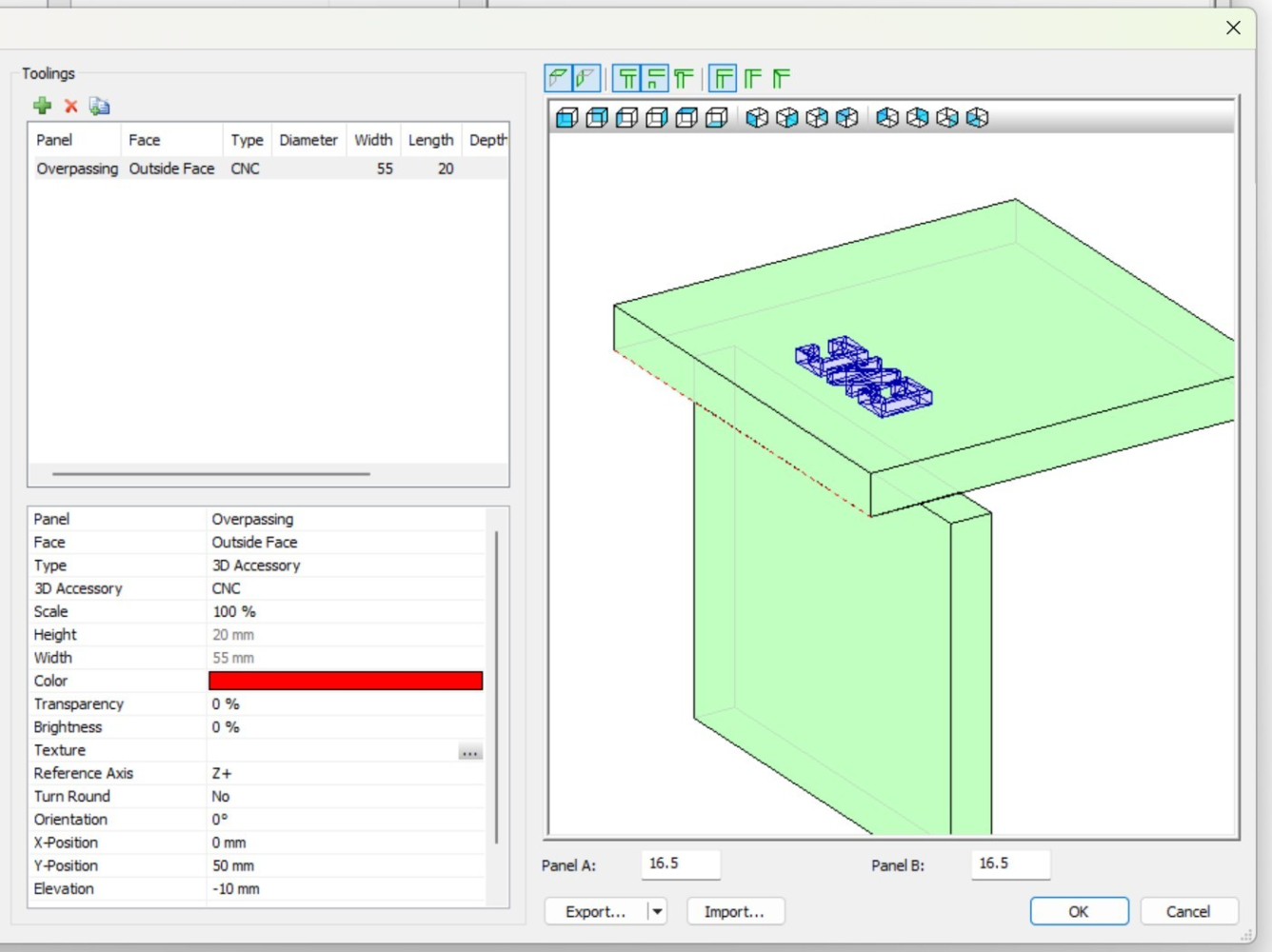

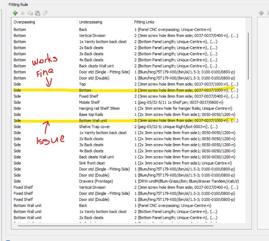

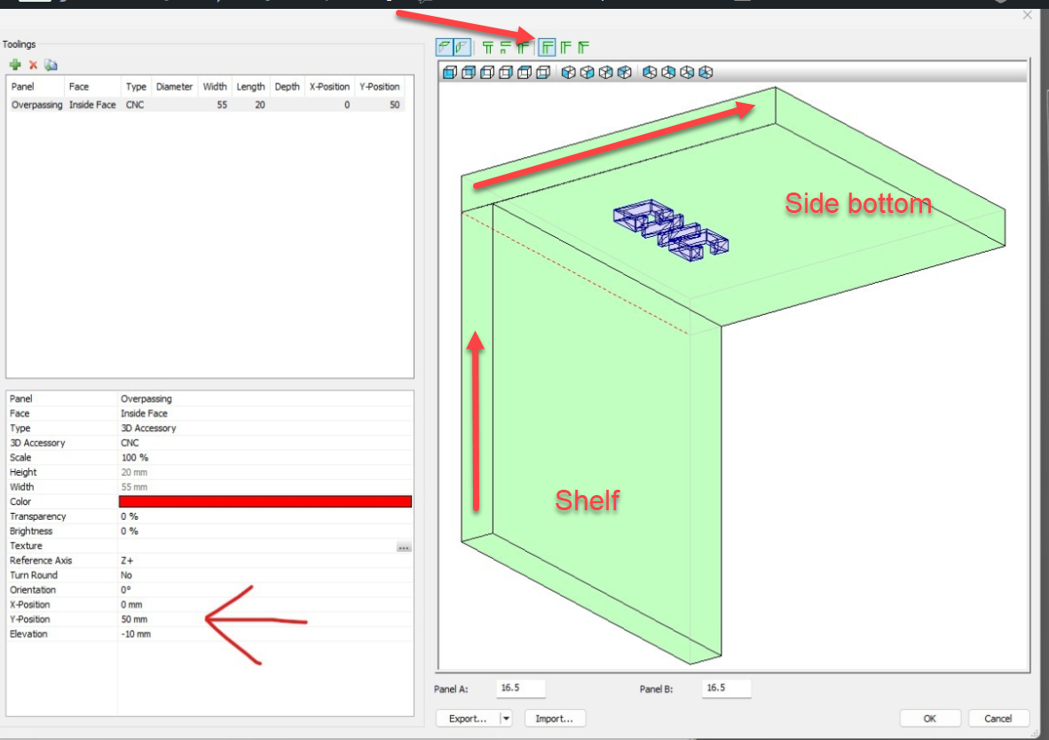

Sorry I do not understand what you are trying to say, I’m saying this tooling acts differently in pb8 as in pb7. The picture in pb8 tooling screen does not look the same as in the 3D design but in pb7 it did. The 3D Accessory is referenced to be placed on the overpassing panel 50mm from the edge of the overpassing panel not the under passing panel. It worked fine in pb7.
As far as I’ve been working on PB for the past few years, a positive dimension (50mm) the Tooling is placed on the referenced panel and a negative value will place it off the panel
CNC4-Medium.jpgImage Enlarger
CNC5.jpgImage Enlarger

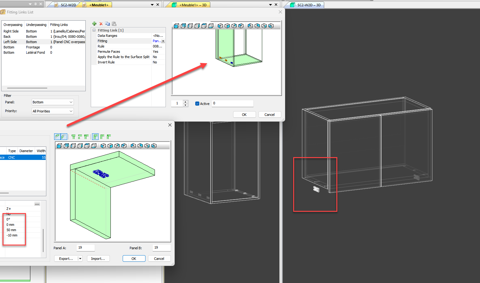

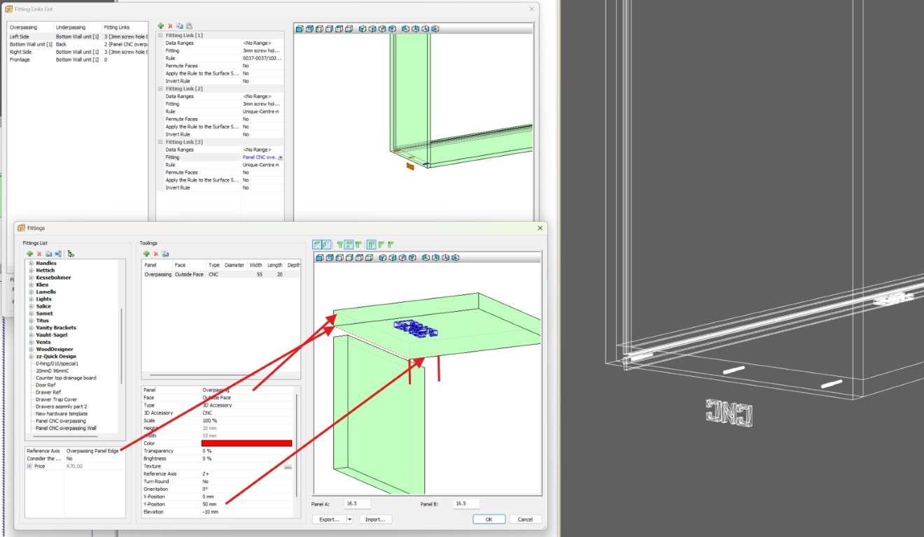

Ho!
I got it this is not an issue here! or issur in PB7 resolved in PB8
I don’t see at first you used fixed shelf as bottom!
If you look your screenshoot, you see part in opposite direction
sc2.pngImage Enlarger
If you moved Shelf you can see all is OK,
Parts-position.pngImage Enlarger
All the best, Alex

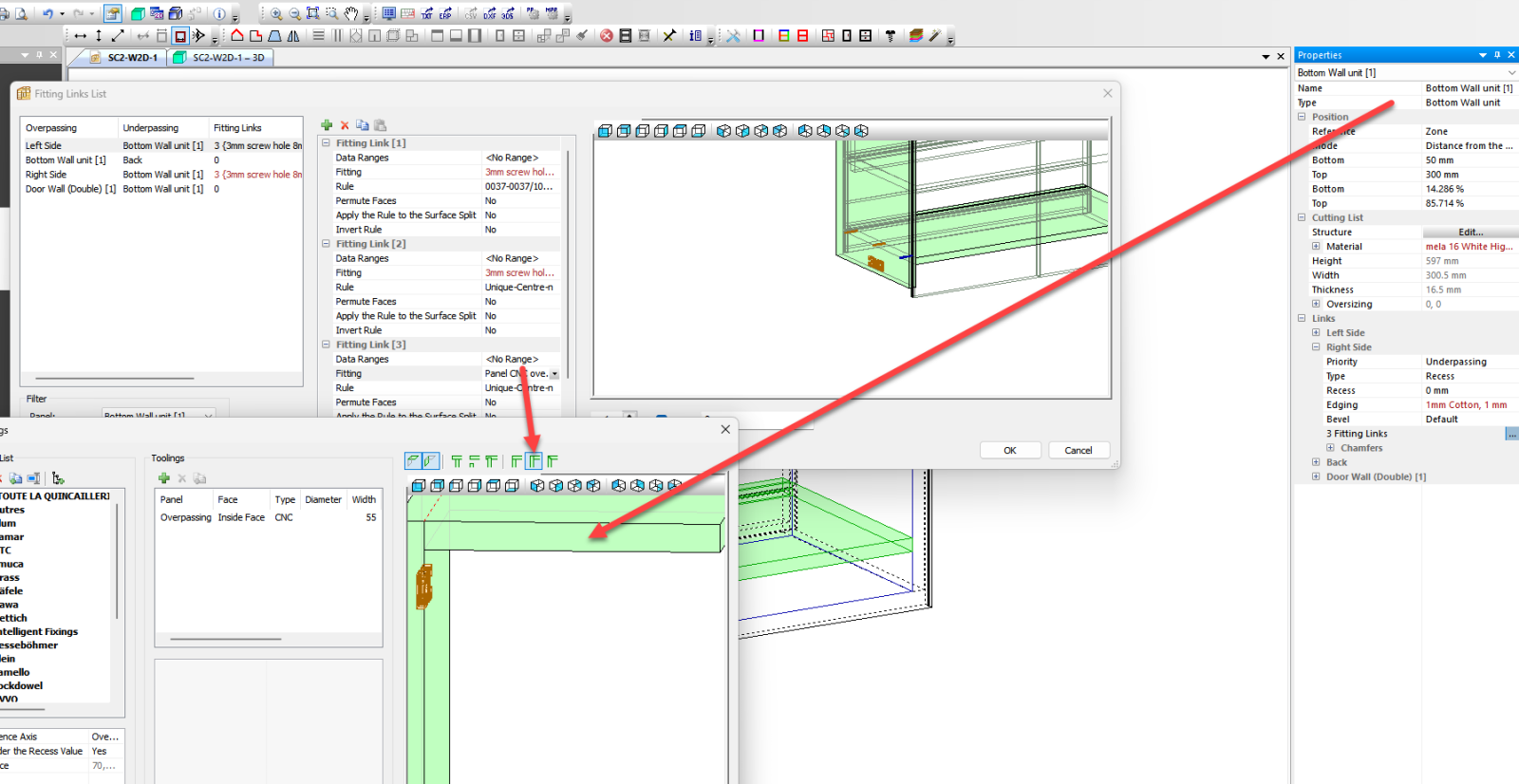

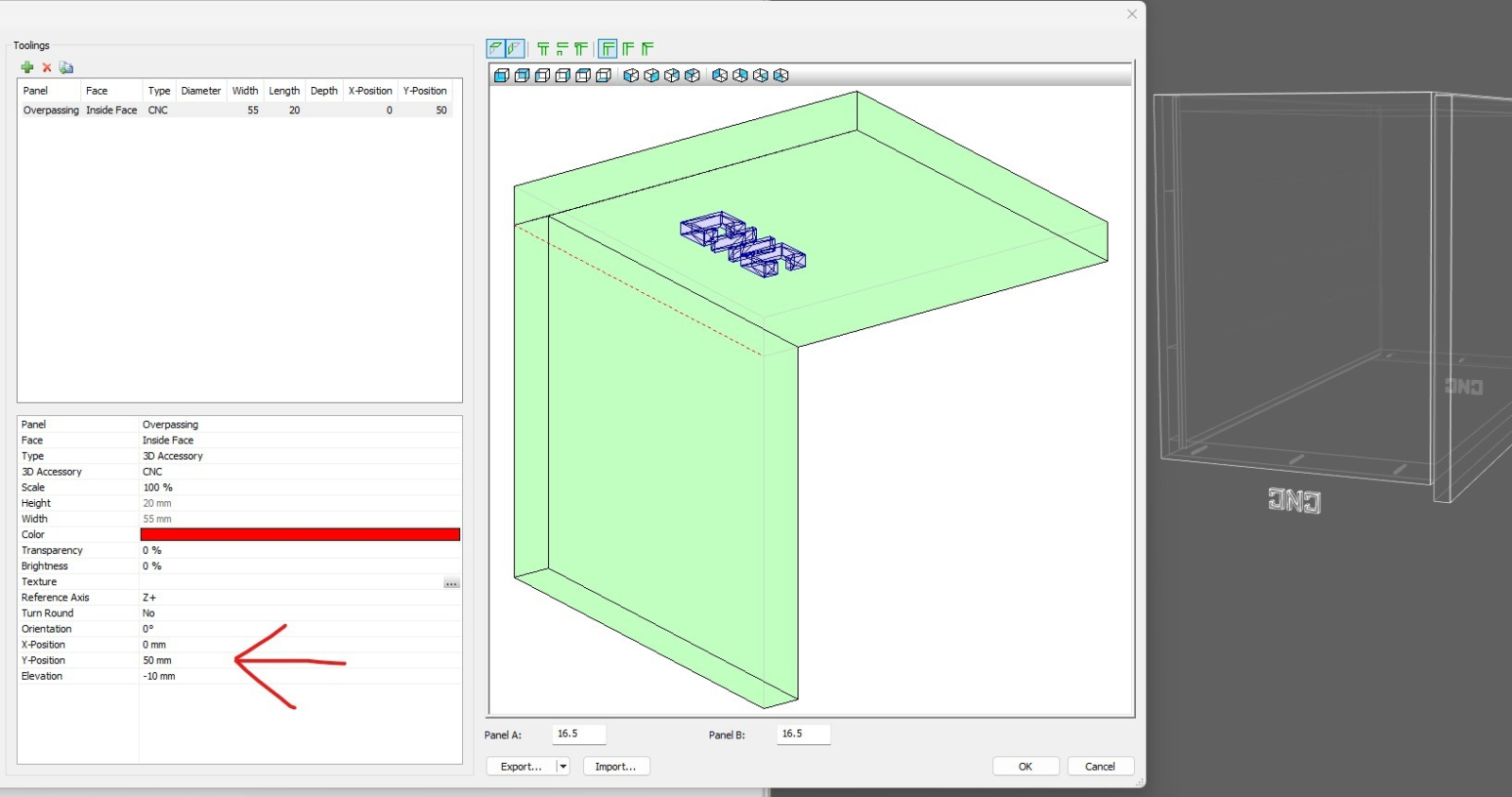

Hi Alex,
I have also made a new cabinet in pb8 and the problem is still there
Please refer to my cabinet. I’ve made a shelve as a bottom panel for the wall units, so I did not use a bottom (boxful) panel. If I use a boxful bottom panel it works fine.
cnc3-Medium.jpgImage Enlarger

Hi Alex,
Please see the Toolings, the image in toolings does not correspond with 3D view
CNC-2b.jpgImage Enlarger
