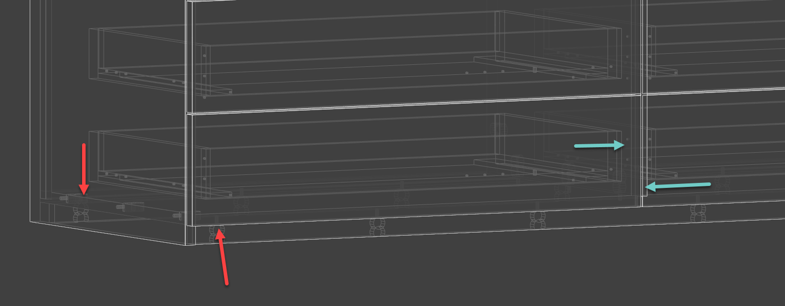

I have restore you setting, and looking at last cabinet Victor-14-drw…
up-and-bottom.pngImage Enlarger
To be clear, STANDBY code fonction is add when part face need to be swape (flippe) and milled/drilled on both face ( like the upright of this cabinet ), and this can’t work with Nesting CNC with option single file per part because that create well single part with STANBY code.

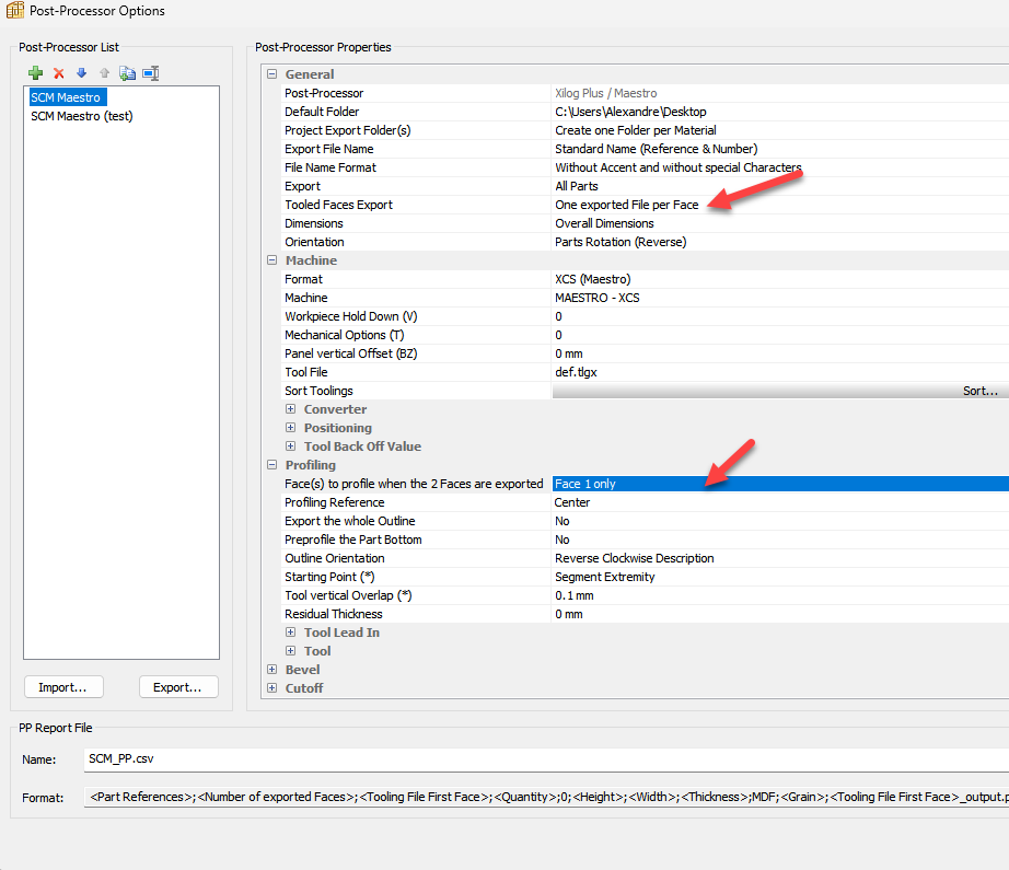

In used with Nesting , the solution is to sort parts with Multi-post processor,
Firstly update your PP to single part per face.(see screenshot below)
PP.pngImage Enlarger
Now Create Multi PP with two filter, the first with your Maestro PP, catch all second face programme to be milled after general Nesting,
Then when you made Multi PP export that’s create First folder for part must be milled after the second folder.
And this Second, is the general Nesting folder must be send to Maestro to cut all Part!
