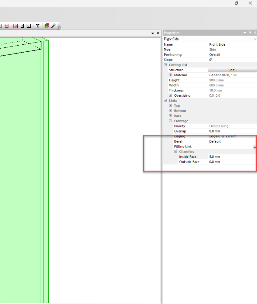

Hello Caroline,
Thank you for the explanation. This needs to be completed in your CAM software. Unless,
The only edge bevelling that can be actioned at the moment in PolyBoard is with the Chamfer tool. This will only angle a corner, rather than add a round. Although, if you assign the correct tool on your CNC machine, this may complete what you need.
Chamfer.pngImage Enlarger

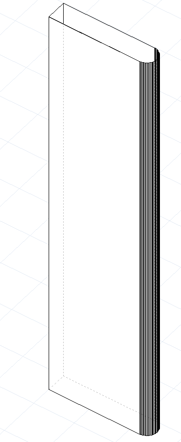

Thanks Isaac for your explanation. Unfortunately it is not what I want to do. Maybe I was not so clear in my description on what I want to do, sorry about that.
It is the frontage of the upright, that is standing from floor to the roof, that I would like to have in a angle, to follow along with the shape of a bench, please see attached photos.
Bench.pngImage Enlarger
Example-of-curved-shape-in-front.pngImage Enlarger
