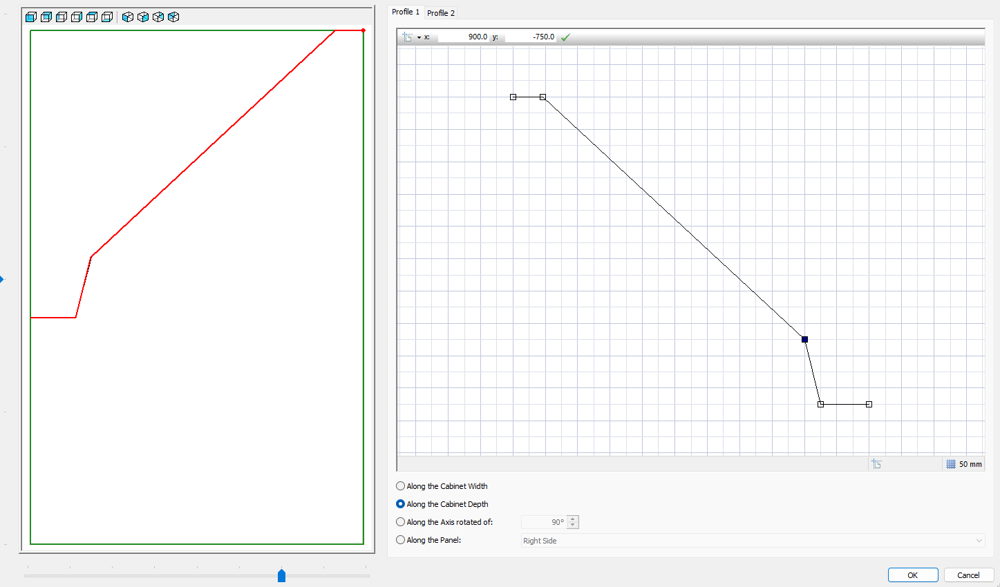

Thanks again Isaac,
  As usual you come up with the goods. Sorted this and even sorted the inner tooling.

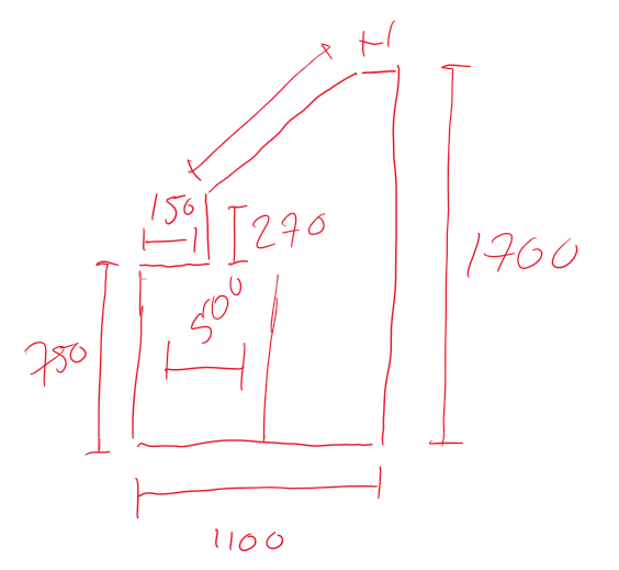

November 11, 2025 - 11:41 am
Sorry Isaac,
  As stated, this is a SIDEWAYS profile, not the front. So the item unboxewd is the back. I need to optimise this today. Any chance you could call?
Forum Posts: 1081
November 11, 2025 - 10:08 am
Hello Dean,
To complete this you will need to first create your left hand side as an upright in your cabinet.
I have completed something similar, and added it here for you to look over.
Let me know if you have any questions.

Hi folks,
  Trying to recreate a shape with a cabinet but having no joy.
The shape is shown below as a sideways profile;
Screenshot-2025-11-10-224956.pngImage Enlarger
The only problem is Polboard won’t let me do the box section at the back… Please see attached.
It won’t let me straighten out the 150 bit so it is horizontal.
Screenshot-2025-11-10-224738.pngImage Enlarger
