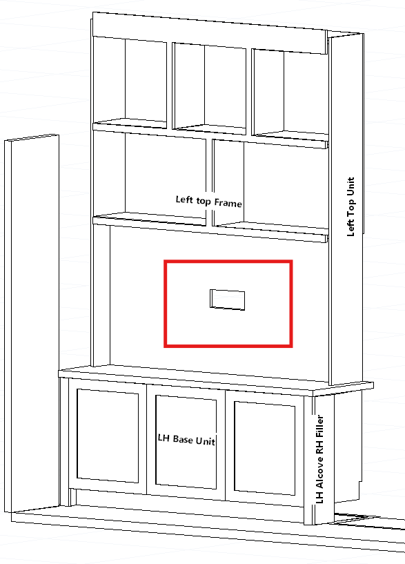

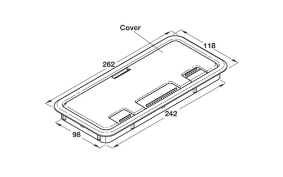

So I add these rectangular cable managements behind TVs etc along with electrical outlet back boxes. Screenshot-2026-02-04-124642.pngImage Enlarger
I constantly have to remind myself of the size to draw them into a panel. Much like this image where i opened the inner tooling and drew up the cut-out I needed and placed it appropriatelyScreenshot-2026-02-04-125432.pngImage Enlarger
Can I save this cut out for when I open up a panel to create some inner tooling I can insert this pre exiting cut out and place it where required rather than having to redraw it continually.
This cut out is rather simple however some are more complex and id like to build up a database of cut-outs that I use.

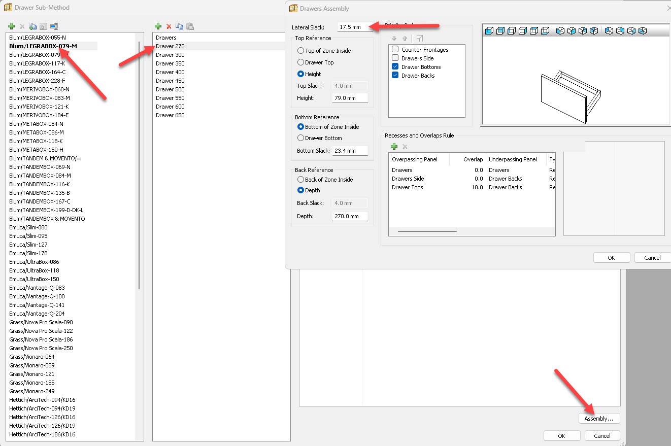

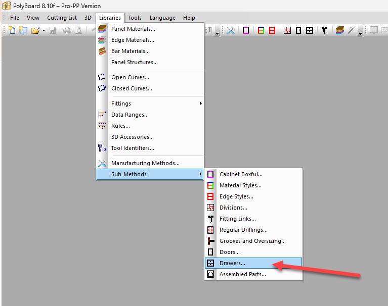

1. To adjust the width of your drawers, open the drawers sub-method as seen in image 1 below:
image-1.jpgImage Enlarger
Then, for each drawer, and depth, you can adjust your size requirements. Reduce the lateral slack value by 1mm (this will remove 1mm from each side):
image-2.jpgImage Enlarger
