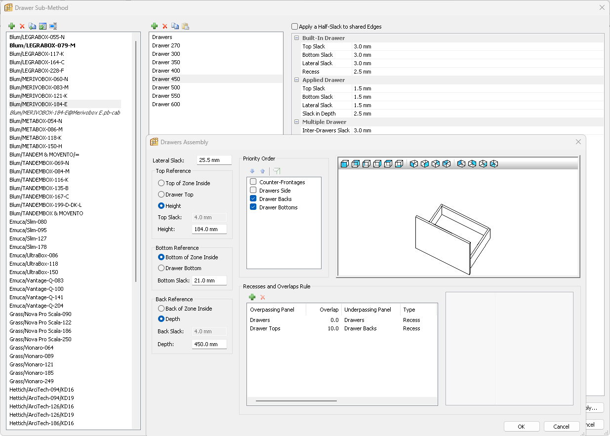

You will need to edit the 500mm drawer to be 500mm long. The parameters for this are showcased in the video previously shared.
I would recommend the possibility of a 1to1 session. If the provided details are not helping you understand, I could spend some time more comprehensively explaining all of the parameters for creating drawers.

Hi Isaac, I’m sorry to say this isn’t working for me.
Your example is 450 deep and I want 500.
I can open your example but when I try to add it to my method or edit it all of the parameters disappear.
I will have to proceed and alter the nests in cad.
It is very frustrating.
Regards, Conor

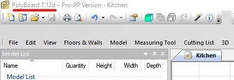

7.12d.jpgImage Enlarger
Yes its 7.12d

Conor,
You will need to confirm the you are using PolyBoard 7.12d to open those files.
Additionally, see the following image. These are the parameters for the Merivobox drawer boxes from our libraries. You can copy these into your sub-methods and adjust as required for your manufacturing.
