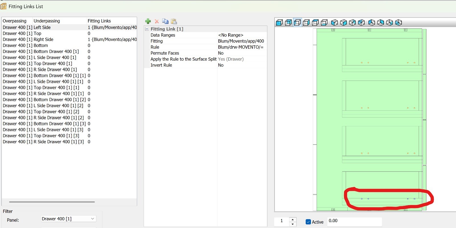

  1. How can we configure Polyboard to ensure Blum Movento drill holes align consistently at 9.5mm from the drawer base, avoiding on-site discrepancies?
  2. For a client needing 145mm of usable height per drawer (including box height + gap above), what’s the best way to set up drawer boxes and runners in Polyboard? Are there specific settings we should adjust (e.g., slack, clearance, or runner positioning)?

We have an issue with the drill holes for Blum Movento Undermount Runners. They seem to be positioned higher than would be expected. Blum technical data suggests that the screw holes should be 9.5mm above the base of any drawer. However, when we input the TOP SLACK and BOTTOM this data seems to move the drill hole locations in relation to the bottom of the drawer.
If we are working to tight margins (as we have done in the past) we notice that the drawer boxes can sometimes hit the top of the cabinet. I think that there is an issue with the parameters within the Blum Movento runners or, we are not correctly understanding/interpreting the way drawer boxes are created?
Please advise?WhatsApp-Image-2025-03-04-at-15.15.07.jpegImage Enlarger
