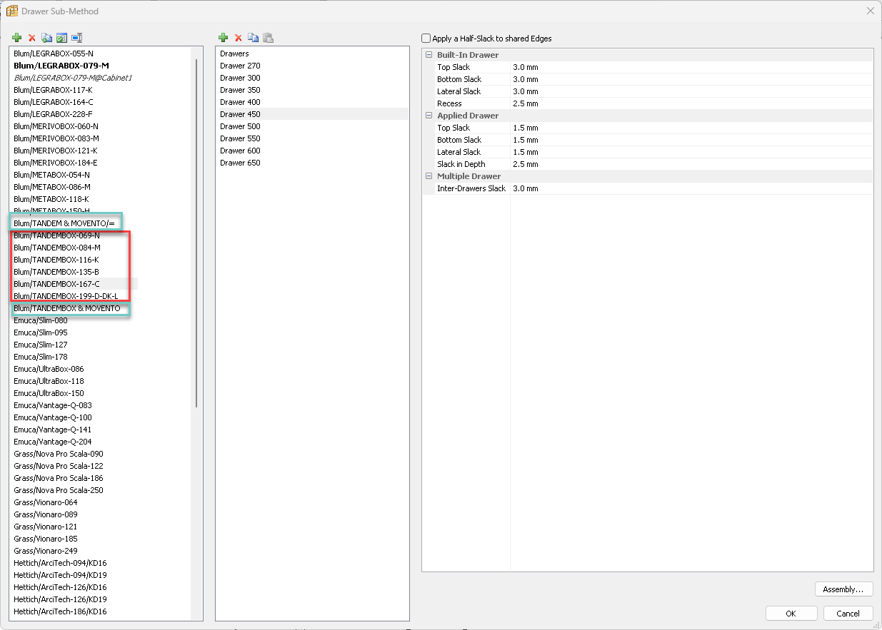

You will notice that in the QuickDesign Libraries (QDL) the:
– Tandem & Movento/= drawers always have drawer boxes that are the same sizes in a drawer bank.
– TandemBox & Movento drawers are referenced differently, and the drawer boxes vary in heights and positions in a drawer bank.
What I recommend, since you are making your own drawer boxes, is that you use our QDL methods as a base, reference our video resources, and adjust the methods as you require for your own specific manufacturing requirements. In this way, you are making your drawers with your requirements, rather then changing what you would normally do in order to comply with our example methods.

Firstly, are you making your own drawer boxes completely, or are you ordering the metallic sides for your Tandembox drawers?
See the following image, the drawers in the Red box are for ordering metallic sides, and the drawers in the green boxes are for making your own drawer boxes (see this further in the Assembly of each sub-method).
Tandembox-drawers.pngImage Enlarger

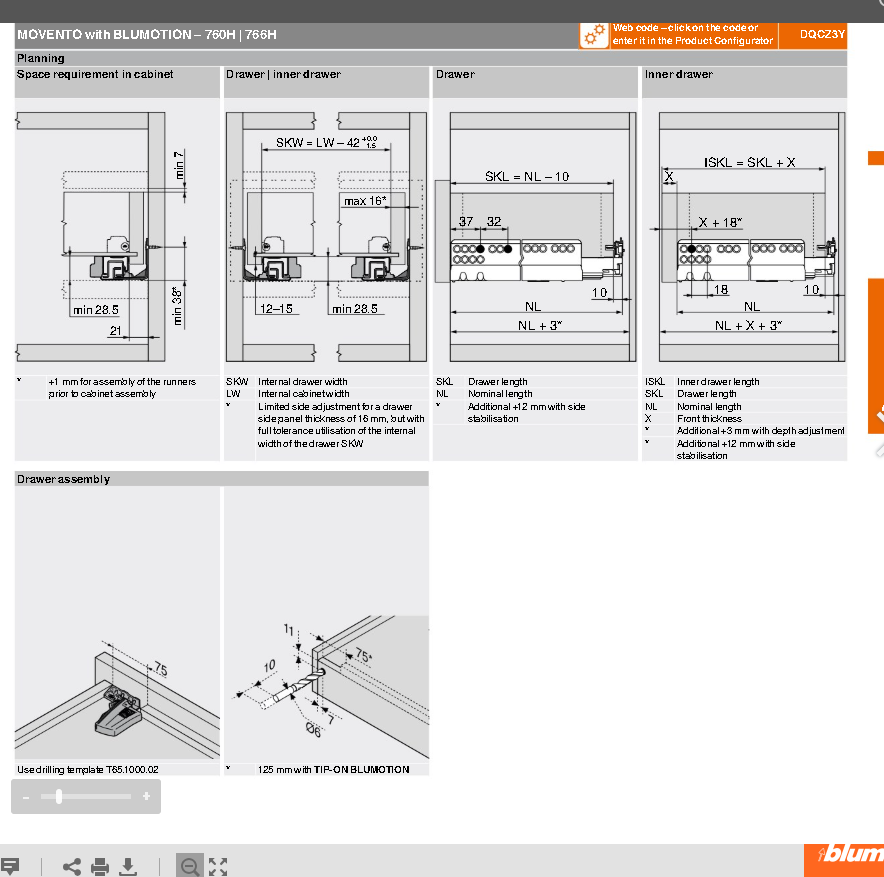

Additionally,
See the following two technical sheets. These are for making timber drawers for the TandemBox and Movento runner systems.
You will see that the manufacturing requirements are the same, except for the minimum distance from the bottom of the drawer to the drawer bottom, these have a minimum distance requirement of 1mm more for Movento. Since this is a minimum requirement, they can both share the larger value.
Therefore, these runner systems have been combined in our libraries.
Movento-Timber-Drawers.pngImage Enlarger
Tandembox-timber-drawers.pngImage Enlarger
