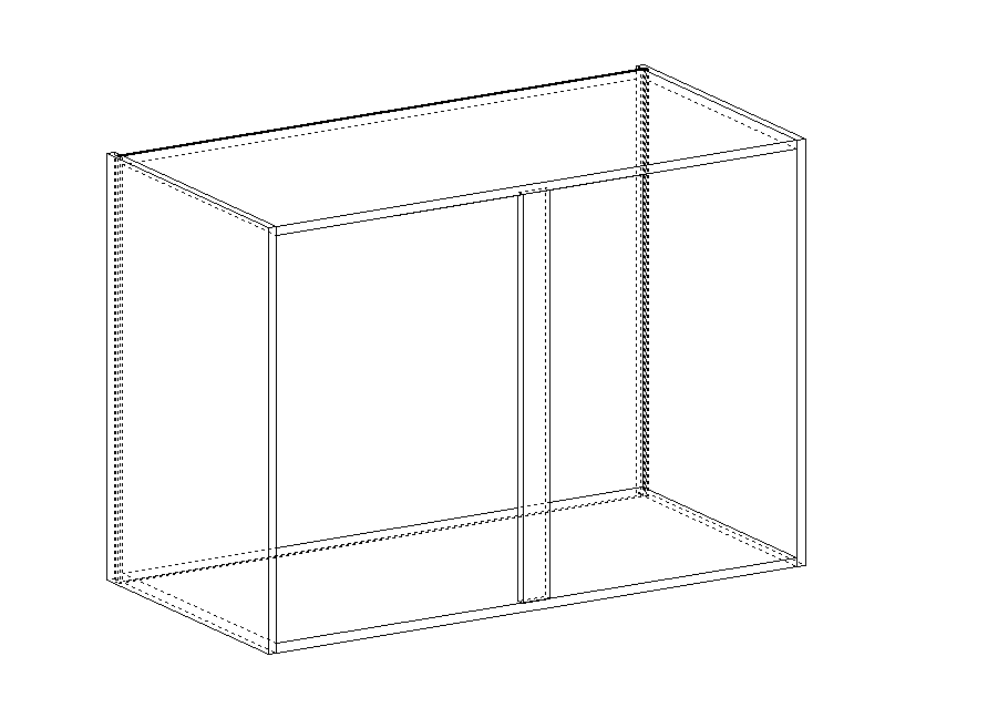

November 18, 2024 - 8:20 am
Hi Dean,
You can use either a ‘free division‘ or a ‘double back‘. Both methods would work in this situation.
As it is a central panel of an assembly, edging this is currently a limitation of this application. If you need this edged in PolyBoard, you could create this type of panel through a ‘surface split‘. The problem with using a surface split is that it would resize as you adjust the width of your cabinet.

November 17, 2024 - 4:03 pm
Thanks Alex,
  Only just got round to putting this into play laugh
Works wonders, although at a loss as to why you chose to do this in double-backs and not free divisions.
Also, can’t find a way of edging each side of this. There is nothing present in edge tooling,
Dean

September 26, 2024 - 10:18 pm
Hi folks,
  Have tried for ages to create a panel structure to create a set size centre post in the middle front of my cabinet. Added it as a Free Division but want it to change when panel structure created, to a 60mm wide centre post(18mm deep). Please see below.
Thanks again
Dean
