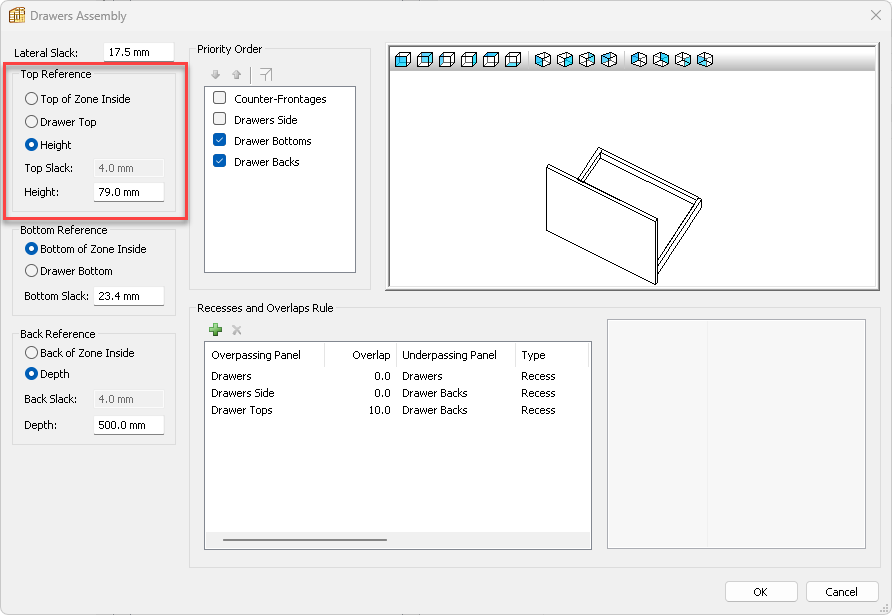

Hello Blake,
Yes, so to adjust the height it is found in the assembly settings. Note, this is the overall drawer box height so you will need to allow for any overlapping panels and gaps added in your rules.

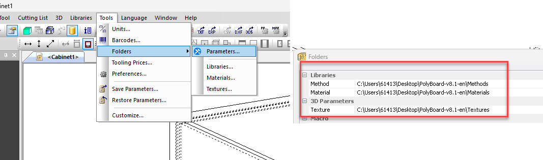

Regarding your libraries, do you have a single folder location for your libraries that is visible across multiple computers? Under tools>folders>parameters you can see the location of your referenced libraries.
2026-05-27_10-22-03.PNGImage Enlarger
Make sure that your library files are in a shared drive/folder location, and they are being referenced on all of your different computers using PolyBoard.
Please let me know if you have any problems with this.

May 25, 2026 - 11:23 pm
Hi Guys
Im adding a new drawer into our library and the drawer back height is not correct and i can not work out how or where to change it?
Blake
