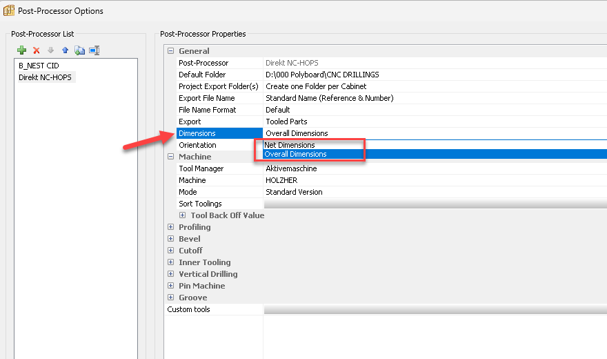

Hello John,
In you Post Processor options, you can choose either Net or Overall dimensions:
– Net dimensions: For no pre-milling, cut at finished size
– Overall dimensions: For pre-milling, cut oversized for pre-milling

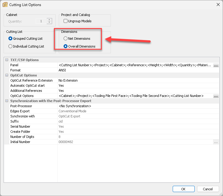

Additionally, if you want to update the cutting list, go to Cut List>Cutting list options. Here, you can choose the same settings.
