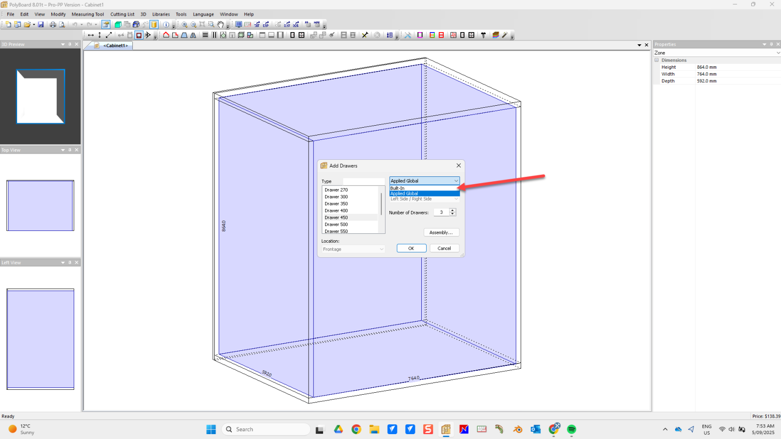

Hello Adam,
If you are asking about recessing them into the unit, you need to set them as Built-In. You can either do this when adding doors/drawers, or in the properties menu. See the following images:
Built-In.pngImage Enlarger
Built-In1.pngImage Enlarger
If you want to adjust the door recesses in relation to the height and width of the cabinet, this can be accessed in the door/drawer sub methods, or in the properties menu. See the following images:
Slack-values.pngImage Enlarger
Sub-methods.pngImage Enlarger
If you are adjusting sub-methods, you can see further information for this here:
https://wooddesigner.org/help-…..g-methods/
