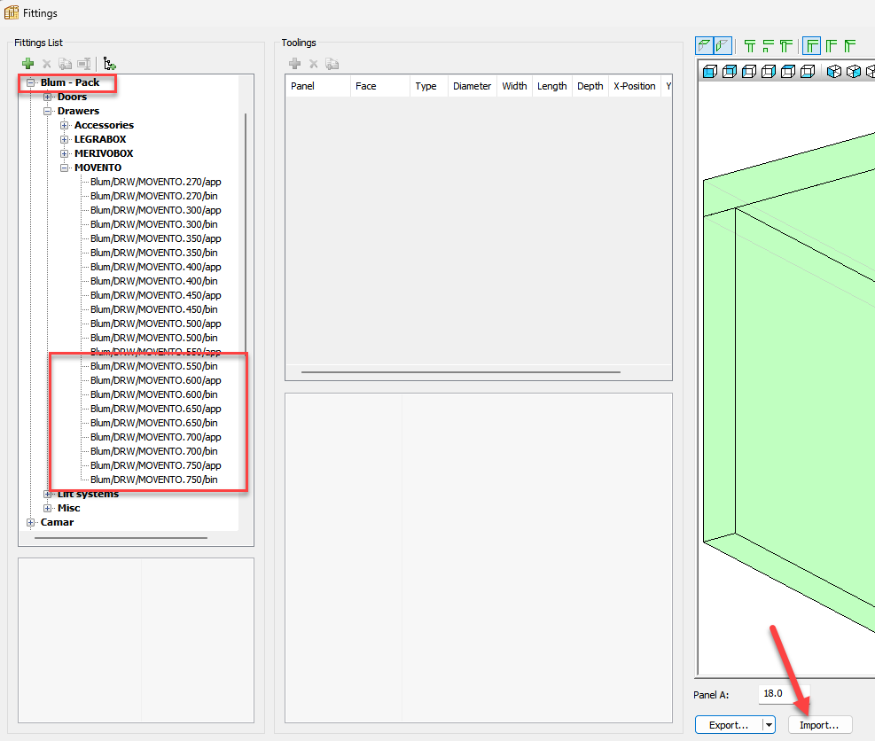

In first step to understand process you can see this video
>[Subscribe to Premium Support to view this media]
Now you have see this video, If length are not listed yet , it is because our quick design libraries are limited up to 650mm per default,
But from menu Tools > Preferences in Facade Components, you can change the number to add news drawers, then edit name as your need
drws.pngImage Enlarger
I have extract and update your fitting for you (Movento is equals Tandem slider), and joined here,
you can import the *XML and update diameters and depth of drilling
pack-blum.pngImage Enlarger
Now it stay to go to drawer sub-methods to add
drw-a.pngImage Enlarger
then adjust each new length
drw-b.pngImage Enlarger
and fitting links sub-method
Hope that’s helpful, Alex

Size 4mm and depth would be 10mm drilling I have attached pic of sheet

Hi I am trying to add tandem soft closed draw runners under mounted  and can’t seem to do it  and how do I add bigger runners 750mm long to library
