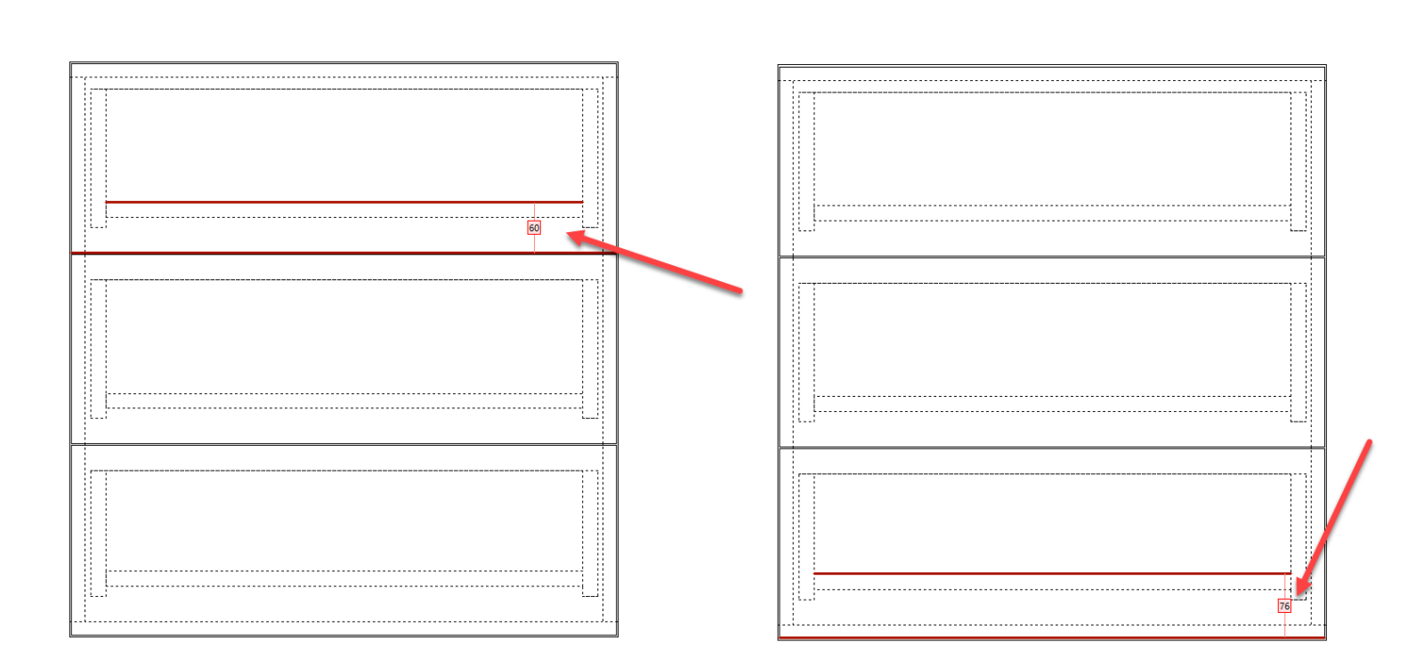

When you have set your drawer fronts up, you have allowed a greater sized bottom drawer as a result of the overlap not being evenly calculated with higher drawers. This is not a problem, except you need to allow for that in these measurements.

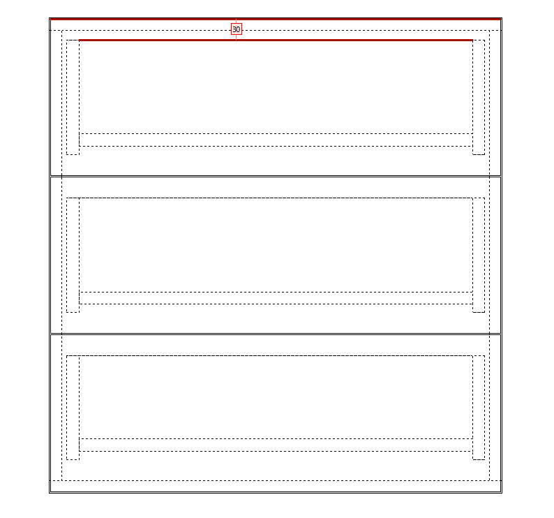

What I recommend is that you reference everything from the top of the panels, as the distance from your drawer fronts to your counter fronts are consistent here at 30mm.2026-03-13_09-31-43.PNGImage Enlarger
Therefore, reference all of your fronts from the top of the panel. Just allow a 30mm difference between the drawer fronts and the counter fronts in your dimensions.

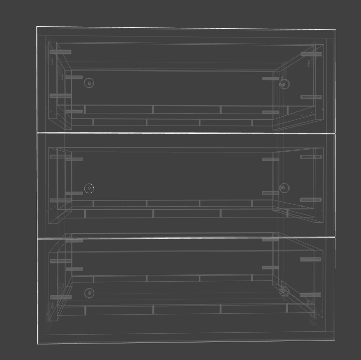

2026-03-13_09-28-51.PNGImage Enlarger
2026-03-13_09-29-14.PNGImage Enlarger

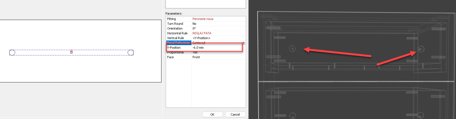

The first one from the bottom is ok, the next one doesn’t go well.

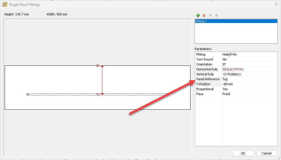

Your single panel fitting rule did not have correct Y-offset. The 20mm, or the 5mm hole need to move by 6mm on the Y-axis.
See the following example from your single panel fittings.
2026-03-12_11-36-03.PNGImage Enlarger

Hello, what am I doing wrong here that the hole on the 20 mm drawer front does not align with the one on the 5 mm drawer, thanks in advance
