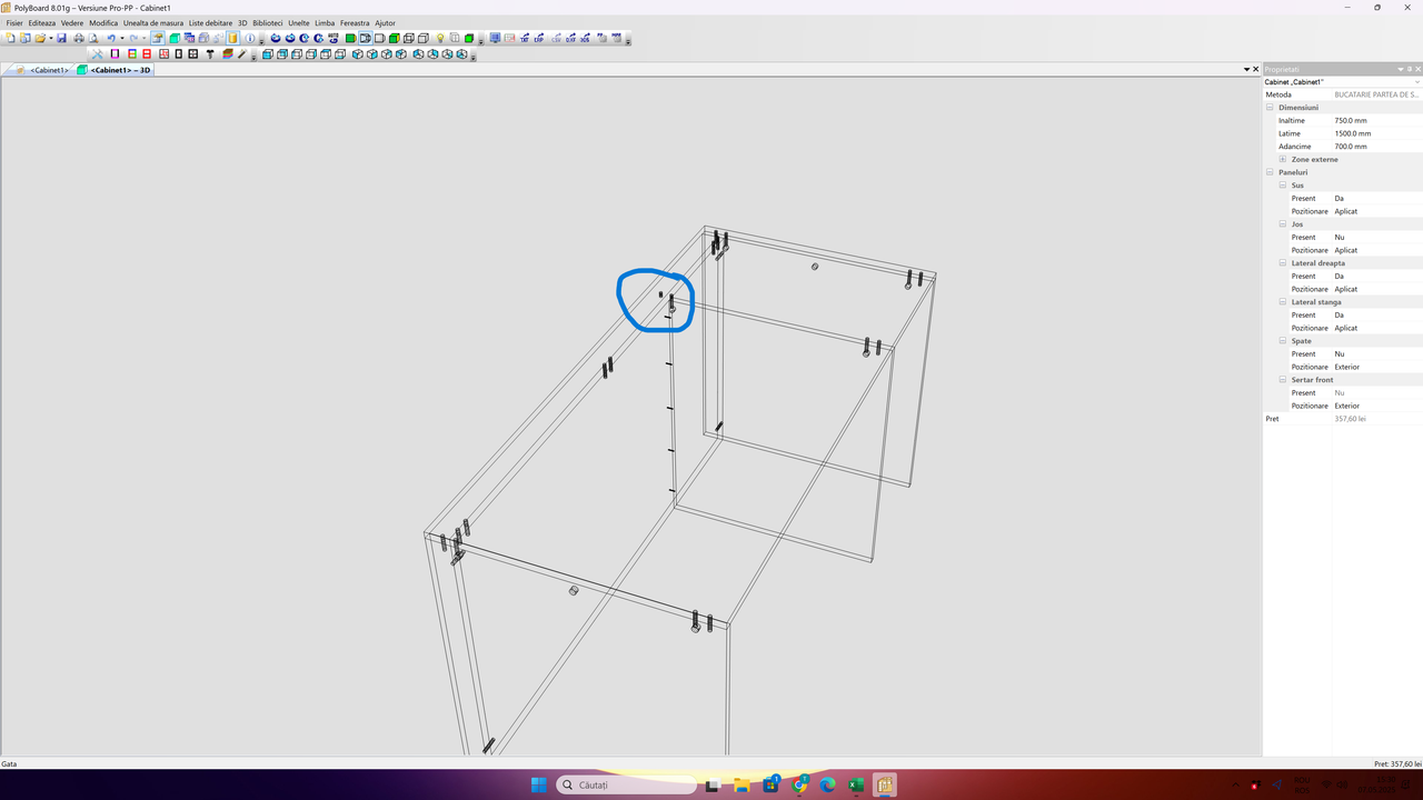

Hi Ilie,
It looks to me like you need to adjust your rule. The rule that your hardware is following can either reference a joints’ Overpassing Panel, Underpassing Panel, or the Internal Zone associated with the joint.
If you send me the cabinet file that you are working with, I will make a video and show you how this can be adjusted.

https://i.postimg.cc/j5ct95pM/…..153010.png
In the picture I posted, the vertical element is not drilling correctly, normally it should not be guided by the size of the piece?
There is a double back that I removed 50 from the back
