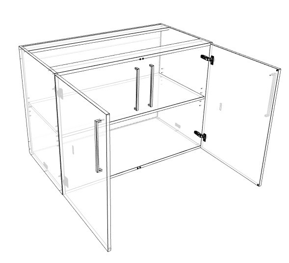

The new update Polyboard 8.01W resolved this issue.

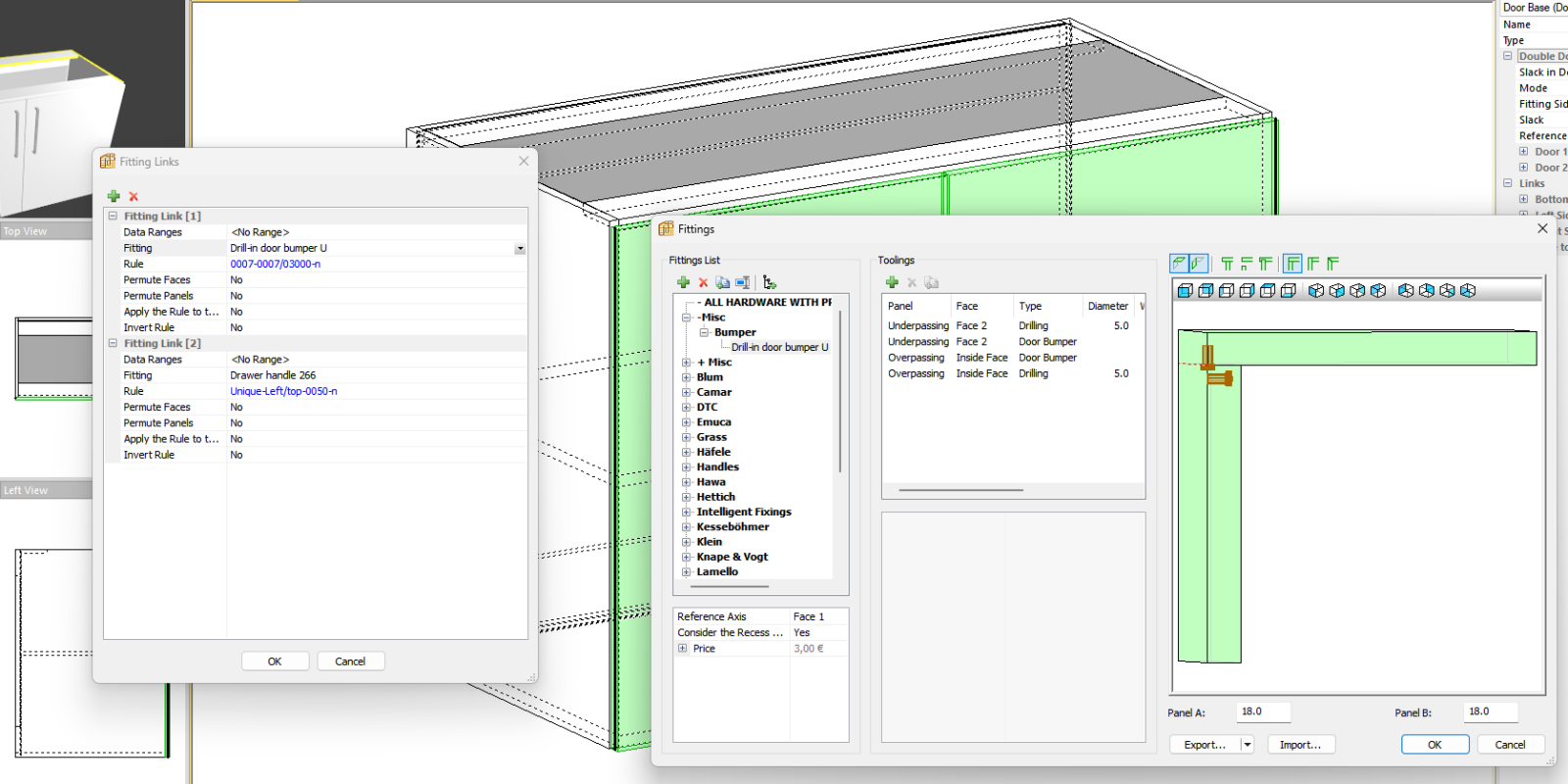

In your case, you used 6 connectors when only 2 were needed.
It’s a good idea to do this in the surface split, but be careful because the visual is not entirely accurate.
In the surface split, both panels are considered as overpassing and underpassing panels.
SP.pngImage Enlarger
All the best, Alex

August 22, 2025 - 1:54 pm
I’ve always use d this fitting rule in PB7 and it worked fine, now for some reason in PB8 it gives me a duplicate handle that stays in the door opening..
Duplicate-hardwere.jpgImage Enlarger
