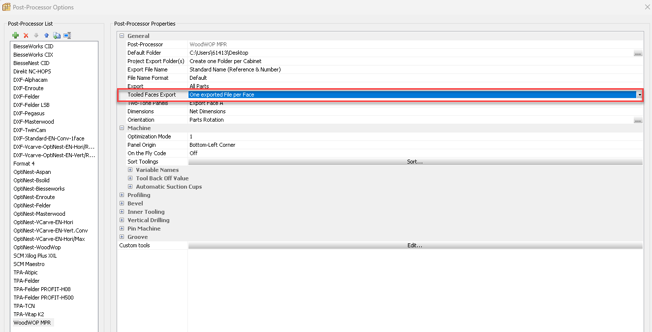

The ZP500_FR.mpr macro is for multiface machining in WoodWOP MPR files.
If you don’t have this macro, then your machine most likely does not need its actions or have its capabilities.
To turn this off, simply access your PostProcessor setup and set:
Tooled Faces Export: One exported File per Face
See the following image:
mpr.pngImage Enlarger
