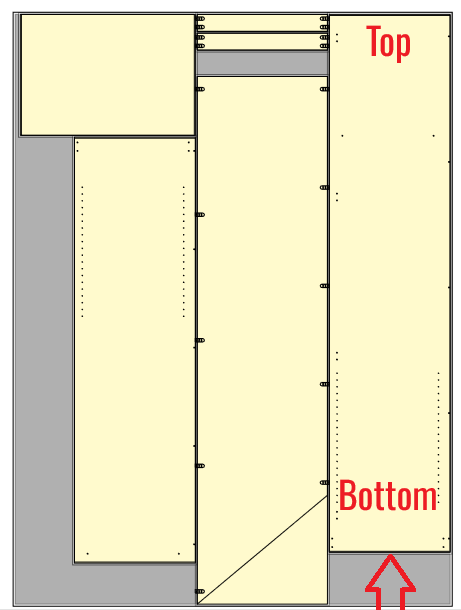

Hi folks,
  While this thread is still active, could I ask about positioning of oversizing? I don’t remember this doing this before, by my Polyboard now seems to be adding oversizing equally to all sides. For fillers and such this is not really a problem as there are no fixings, however on unit side panels (for example angled units) this is also sharing the oversizing when this should only be at the top. Please see attached for Optinest result example.
Dean

16
April 20, 2025 - 2:59 pm
Seems a bit bizarre treating oversizing and angle cutoffs the same but not to worry, as long as I know I can work round it.

Forum Posts: 1441
15
April 16, 2025 - 10:57 am
Dean,
This is correct. Oversizing will need to be added manually in VCarve or OptiNest if it is turned off.
