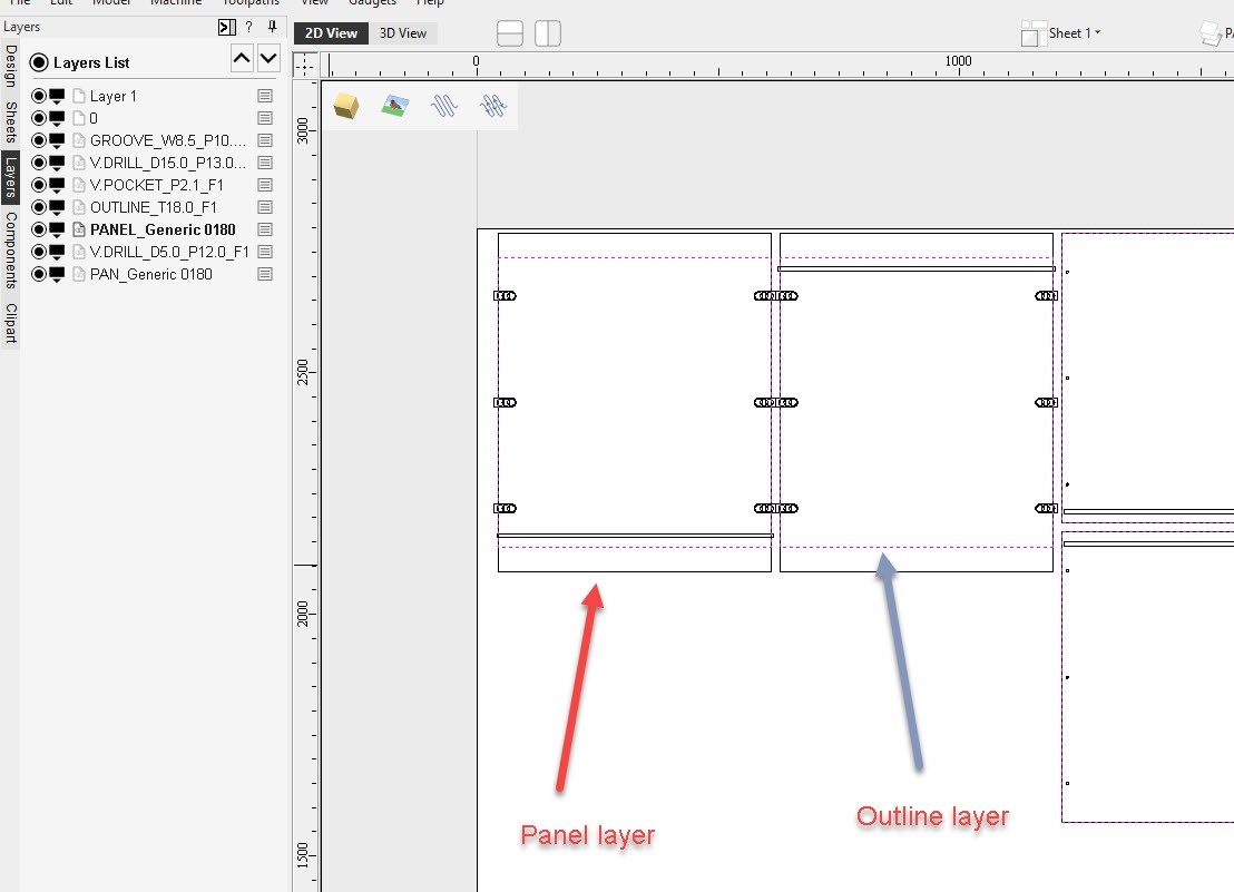

March 31, 2025 - 2:51 pm
Hi Dean,
There is no way to swap these, the oversizing is the Panel layer.
The 0 layer, this is nothing, a non-existent layer. This can be ignored or deleted.

March 7, 2025 - 8:09 am
Hi Dean,
Correct, you will see both layers exported. This is important if you are also exporting other components that do not have oversizing.
See the attached image, I recommend manually selecting and deleting the layer which you don’t need.
Panel-and-outline-layer.jpgImage Enlarger

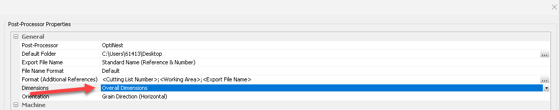

March 3, 2025 - 8:09 am
Hi Dean,
There are a few possible reasons, firstly confirm that you have your DXF PP set to “Overall Dimensions”. See the following image:
Overall-dimensions.pngImage Enlarger
Let me know how this goes.
