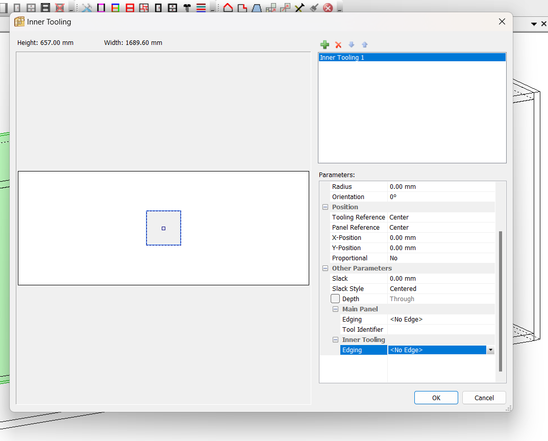

Hi
due to me doing a 4mm lighting channel with inner tooling when i want to do a bigger cut out it presents these on the same layer when exporting to alphacam.
a way around this i have found is to make a cut out with a radius corner greater than the cutter i would like to use, so i would like to use 12.7 cutter so would like to fillet the corners to 6.5mm this will force our cnc to pick up the 12.7 instead of the 4mm to try and do the tighter corner.
thanks
Screenshot-2025-01-21-090142.pngImage Enlarger
