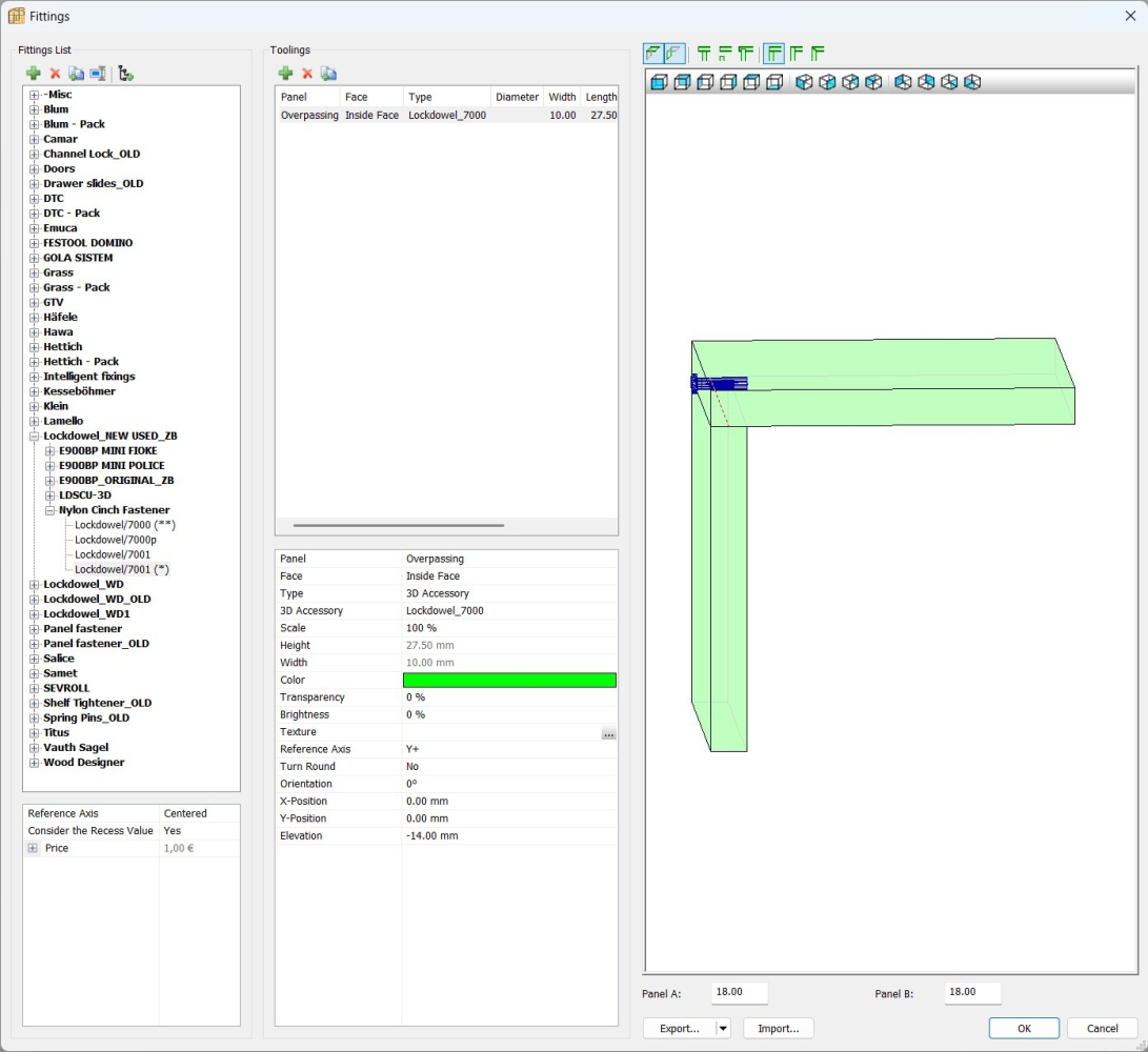

Hi Isaac, it is working ok. Thank you. Need to start thinking different way.
About importuning through skp files, New 2025 Pro version does not support extension manager. I will try to use my Fusion360 and try that way. If you have any other suggestion let me know.
What CAD data base is best to use for furniture and cabinet accessories ?
Using Sketchup and export to 3D DXF didn’t work for Polyboard
Thank you very much

Hi Zack,
Additionally, see the following link explaining making and importing 3D elements.
https://wooddesigner.org/help-…..cessories/

Hi, here is the original file
quick question, what will be the best way to import handles or other 3d parts?

Can you please send me a copy of this cabinet? I will look at this for you.

Hi All,
I am trying to create a fitting option for LD 7000 Panel fastener on counter-frontage drawer and drawer bottom. I am using same fitting for fastening the back of the cabinet to the cabinet sides, and it is working very well.
for the reason of the drawer slider installation, I had created drawer library with counter-frontage -3mm (allow for drawer bottom slide over the counter-frontage-picture attached from the library)
drawer-setup-1.jpgImage Enlarger
I want to install 7000 panel fasteners from the bottom of the counter-frontage and through 3mm bottom of the drawer to lock it in the placeLD-7000-PIN-USED.jpgImage Enlarger
Using Fittings library, I had tried to setup a drilling and position of the 7000 fastener, which is not working.
BOTT-DRW-WITH-LD7000.jpgImage Enlarger
fittings-7000.jpgImage Enlarger
