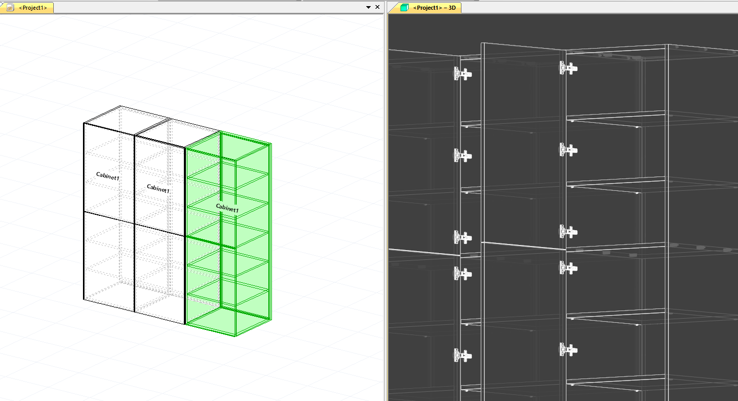

there is no way to see fitting in 3D,
But the solution may be to use 3D accessories, because they are displayed in 3D.
for exemple hinges, shelves pegs, and cabineo, you are able to create 3D dowels too for exemple , but the more 3D you add, the more it will require additional resources and therefore an increasingly powerful PC.
3D.pngImage Enlarger
All the best, Alex

Is there a way to enable bwing able to see fixings in Project View? I can see panels structures that drill right through a panel, but not drillings and such.
Dean
