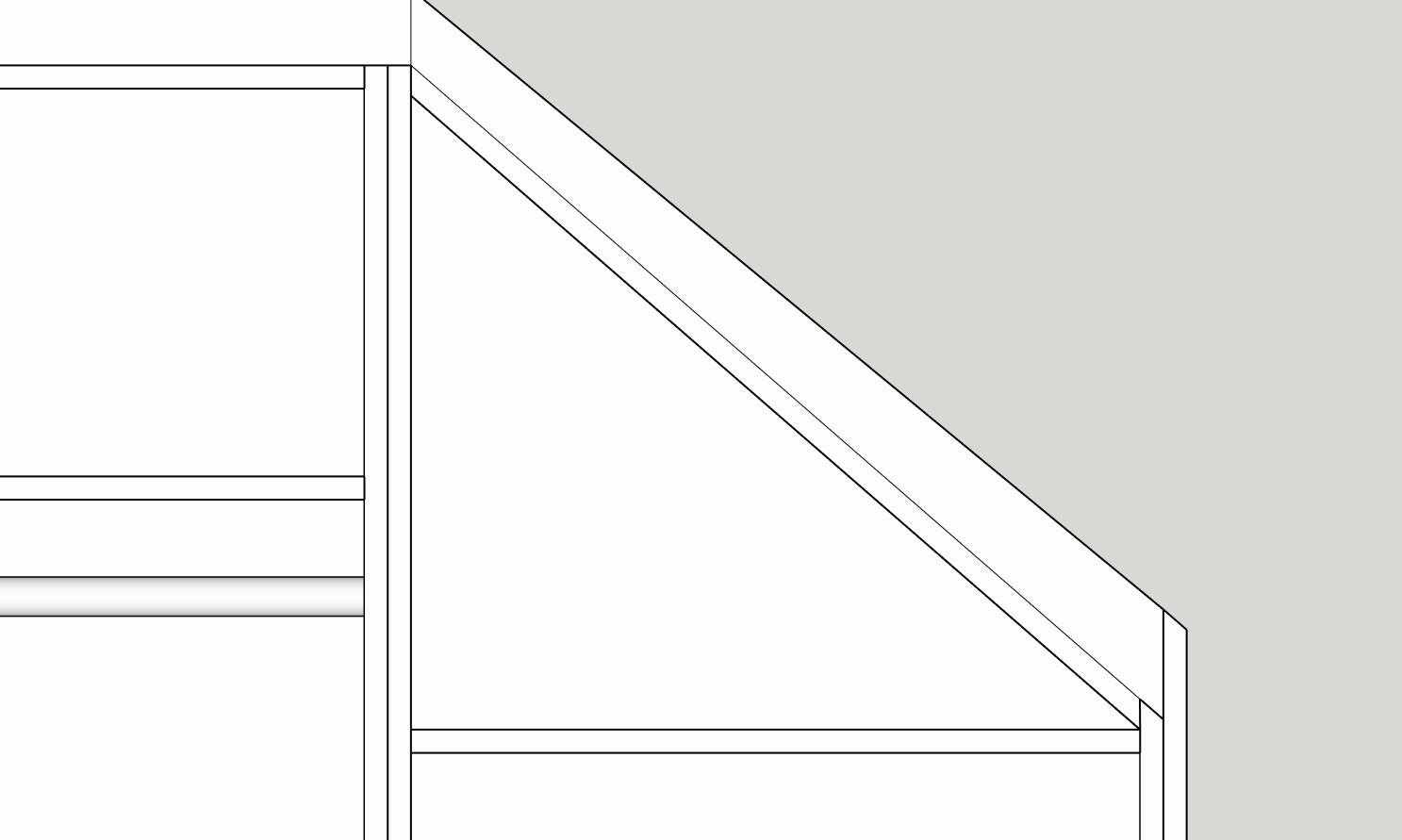

August 7, 2025 - 1:20 pm
That did the trick.

August 7, 2025 - 12:39 pm
Hello Dermot,
When completing this type of slope in PolyBoard, I would allow for the additional 15.2mm in the height of your cabinet.
I would add this to the total cabinet height.

August 7, 2025 - 12:26 pm
Thanks Isaac
The height of the panel is now changed and I need it to be 2200 high but as removing the chamfer has clipped 15.2mm from the height and yet the overall cabinet height is saying 2200.
Forum Posts: 1441
August 7, 2025 - 12:04 pm
Hello Dermot,
See the attached video:

August 6, 2025 - 1:40 pm
Chamfers on GabFront-angles.jpgImage Enlarger
How can I get polyboard to produce gable cuts like the attached picture. When I use slope on the top, it chamfers the gables on both sides. I need the left hand gable to be sqaure at the top and not chamfered. The right hand gable is chamfered perfectly and I want this to be like this for scribing my filler piece but the left hand gable needs to be sqaure.
Dermot
