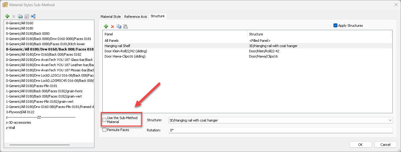

Hello Girts,
When you add a structure, it will use the material it was created from. If you want it to follow your sub-method, see the following image:

Hello Girts,

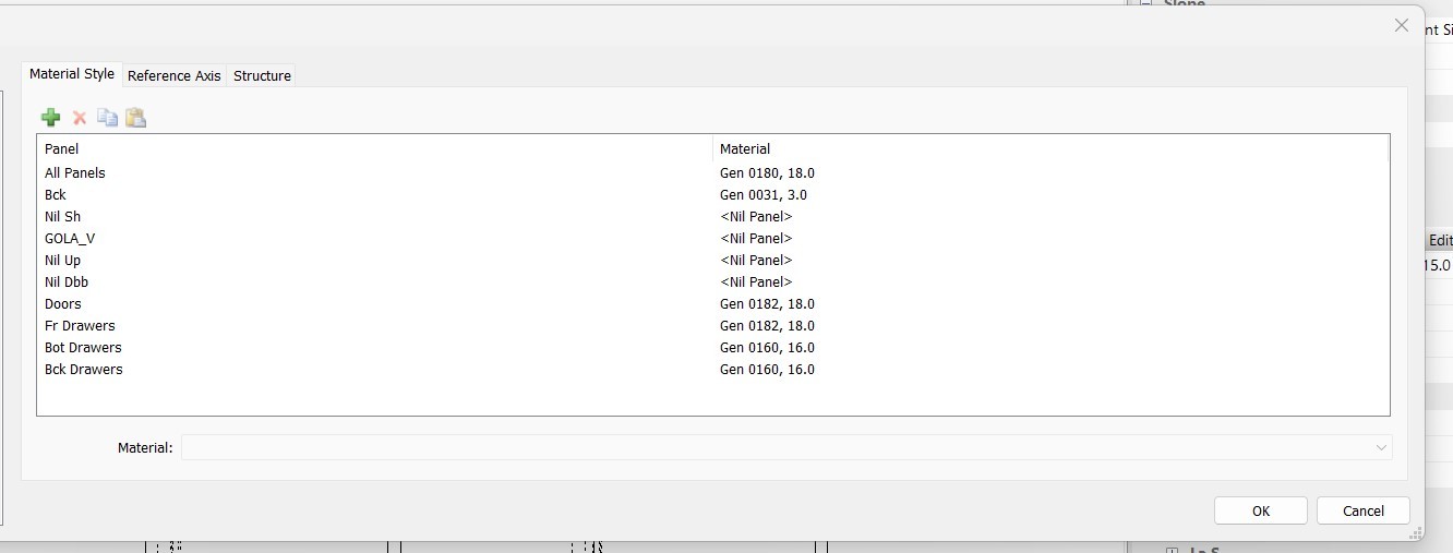

I have a problem – as soon as there is chosen structure to panel for cabinet boxful – it changes material to Gen 15, but in conditions it is shown correclty:
