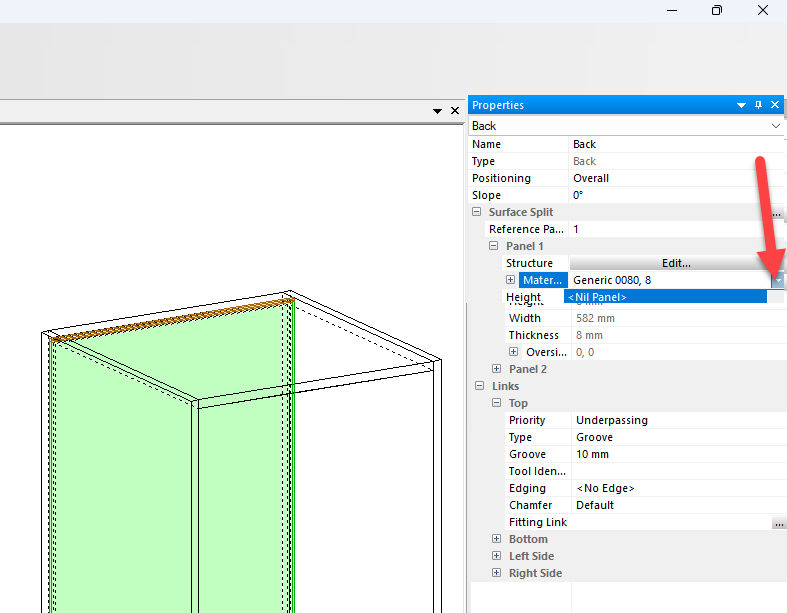

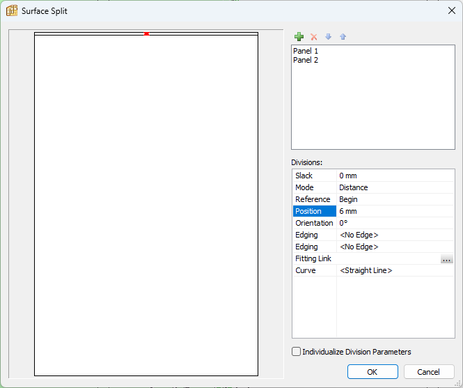

You can’t make exceptions with depth slack,
but you can do Surface split… from top at 6mm (1mm slack)
ss.pngImage Enlarger
and set this 6mm panel as nil,
nil-pan.pngImage Enlarger
this can be save into structure libs, and applied to all back, from materials sub-method, tab “Structure”

If I have a cabinet with a back engraved from 4 sides, and I want to use peanut connectors, how can I make the groove slack only from one side ( top side) bigger than the others?
(the groove slack from 3 sides should be 1mm and from 1 side 7mm).
I tried to do it in the groove and oversizing submethod but I couldn’t do an exception for one side only.
